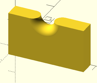

http://forum.openscad.org/file/t824/cubeminustorus.png
Is this the result you experience, or is this the result you desire to
accomplish?
I did nothing to your code other than to reduce $fn to 60, as 360 means
excessive processing time and doesn't (shouldn't?) affect the final result.
I'm using 2017.1.20 on windows 7, which may be relevant if this is your
objective.
<http://forum.openscad.org/file/t824/cubeminustorus.png> Is this the result you experience, or is this the result you desire to accomplish? I did nothing to your code other than to reduce $fn to 60, as 360 means excessive processing time and doesn't (shouldn't?) affect the final result. I'm using 2017.1.20 on windows 7, which may be relevant if this is your objective. -- Sent from: http://forum.openscad.org/

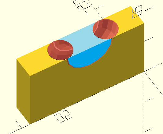

No, what I want is to keep the yellow and red parts, and remove the blue
parts. Not sure if I'm doing this right to attach an image or not (it's
inlined in the email).
