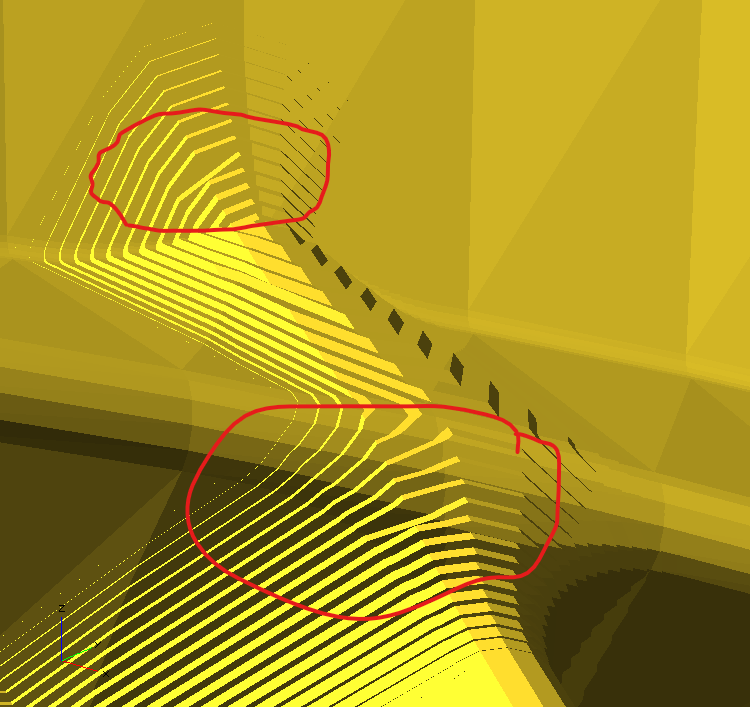

would request some of you to please check if f6 render works.
Renders on current nightly (1.85s Manifold, in CGAL 2m04s - 25s building
rest final union 999/1000)
& 2021.01 (on a slower PC 4m57s most in final union).
In CGAL, both versions, it shows 44 of:
PolySet has nonplanar faces. Attempting alternate construction
Result has some minor strange flater bits, see attached.

Tue, Sep 2, 2025 11:22 AM
Thanks
This issue will reduce when the resolution is higher and maybe much less
visible.
I have a higher resolution model, It's file size is around 4 mb so
difficult to post here.
