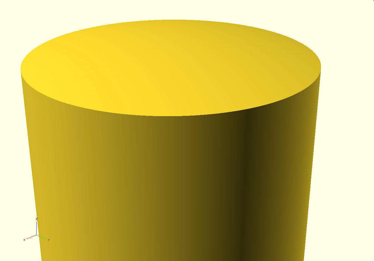

How smooth do you need it? It looks very smooth to me with $fn = 1000.

How smooth do you need it? It looks very smooth to me with $fn = 1000. [image: image.png] On Thu, 10 Jan 2019 at 18:56, Andy Carlson <andycarlson@acm.org> wrote: > Below is a very cut down sample of my model… which in reality is doing > rotate_extrude on a DXF. > > > > It creates a cylinder with a shallow dome on the end. The trouble is that > I seem to be unable to smooth out the ‘tree rings’ on the end sufficiently. > > > > If I reduce $fa to 0.5 then the end becomes coarser instead of smoother. > I’ve also experimented with $fn and the end gets smoother up to a value of > about 570 and then it gets worse. Messing with $fs doesn’t seem to help > either. > > > > Is there anything I can do to get past this problem? > > > > $fs=.05; > > $fa=.632; > > > > rotate_extrude(convexity=10) { > > intersection() { > > circle(16.9); > > translate([-3,0,0]) { > > square([3,20]); > > } > > } > > } > > > > Regards, > > Andy > _______________________________________________ > OpenSCAD mailing list > Discuss@lists.openscad.org > http://lists.openscad.org/mailman/listinfo/discuss_lists.openscad.org >

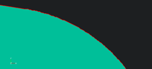

Here are my notes:
  1. I could not see the artifacts you have noticed with the rotate_extrude;
    the extrusion seems to be smooth; I am using OpenSCAD
    http://www.openscad.org version 2018.01.06*;*
  2. the render of the import polygon of end-dome.dxf (without extrusion)
    shows a series of concavities along the rounded part for $fn values greater
    than 150 as shown bellow:
[image: end-dome-dxf.PNG]
these artifacts are not present in the dxf when viewed with LibreCAD;
  1. I could "fill" those concavities with a tricky code that makes the
    hull() of just that section of the polygon:
module endDome() import("end-dome.dxf", $fn=1000);
hull() endDome();
translate([0,-9.9]) square([2.7, 10]);
endDome();
after that, I could generate a new dxf of a new polygon;
  1. the render of the new dxf does not show any artifact.
My conclusion: there is something in your dxf file that is not digestible
by OpenSCAD.
The trick I have used to "clean" end-dome.dxf may be applied to other files
in a case by case basis but it is not neither general nor easy.
For your consideration I have attached the new dxf.

Here are my notes: 1) I could not see the artifacts you have noticed with the rotate_extrude; the extrusion seems to be smooth; I am using OpenSCAD <http://www.openscad.org> version 2018.01.06*;* 2) the render of the import polygon of end-dome.dxf (without extrusion) shows a series of concavities along the rounded part for $fn values greater than 150 as shown bellow: [image: end-dome-dxf.PNG] these artifacts are not present in the dxf when viewed with LibreCAD; 3) I could "fill" those concavities with a tricky code that makes the hull() of just that section of the polygon: module endDome() import("end-dome.dxf", $fn=1000); difference(){ hull() endDome(); translate([0,-9.9]) square([2.7, 10]); } intersection() { endDome(); translate([0,-9.9]) square([2.7, 10]); } after that, I could generate a new dxf of a new polygon; 4) the render of the new dxf does not show any artifact. My conclusion: there is something in your dxf file that is not digestible by OpenSCAD. The trick I have used to "clean" end-dome.dxf may be applied to other files in a case by case basis but it is not neither general nor easy. For your consideration I have attached the new dxf. Em qui, 10 de jan de 2019 às 18:56, Andy Carlson <andycarlson@acm.org> escreveu: > Below is a very cut down sample of my model… which in reality is doing > rotate_extrude on a DXF. > > > > It creates a cylinder with a shallow dome on the end. The trouble is that > I seem to be unable to smooth out the ‘tree rings’ on the end sufficiently. > > > > If I reduce $fa to 0.5 then the end becomes coarser instead of smoother. > I’ve also experimented with $fn and the end gets smoother up to a value of > about 570 and then it gets worse. Messing with $fs doesn’t seem to help > either. > > > > Is there anything I can do to get past this problem? > > > > $fs=.05; > > $fa=.632; > > > > rotate_extrude(convexity=10) { > > intersection() { > > circle(16.9); > > translate([-3,0,0]) { > > square([3,20]); > > } > > } > > } > > > > Regards, > > Andy > _______________________________________________ > OpenSCAD mailing list > Discuss@lists.openscad.org > http://lists.openscad.org/mailman/listinfo/discuss_lists.openscad.org >
AC
Andy Carlson
Sat, Jan 12, 2019 8:14 PM
Thanks for your reply and effort on this.
While I would not rule out an issue specific to the DXF import or my DXF file in particular, I’ve completely eliminated that DXF from my full model and redrawn the dome using OpenSCAD primitives.
The ‘primitives’ version is nice and smooth when run on its own but when added back into the full model (and the dome DXF removed), the tree rings are still there.
I think you may be right about concavity. I suspected that the tree rings may involve the edges of some rings being indented but it’s difficult to be certain.
Regards, Andy

I think the DXF import draws arcs with the normal $fn, $fs, $fa settings
but it then snaps it to a coarse grid, which is 1/1024. I don't think that
is done anywhere else. The normal grid is 1024 times less than that. I.e.
about nano metres instead of microns.
