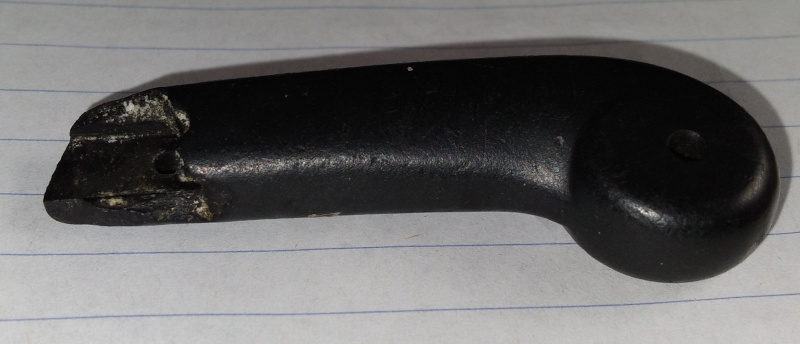

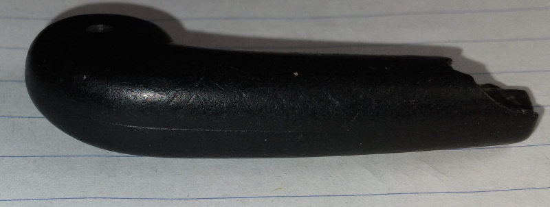

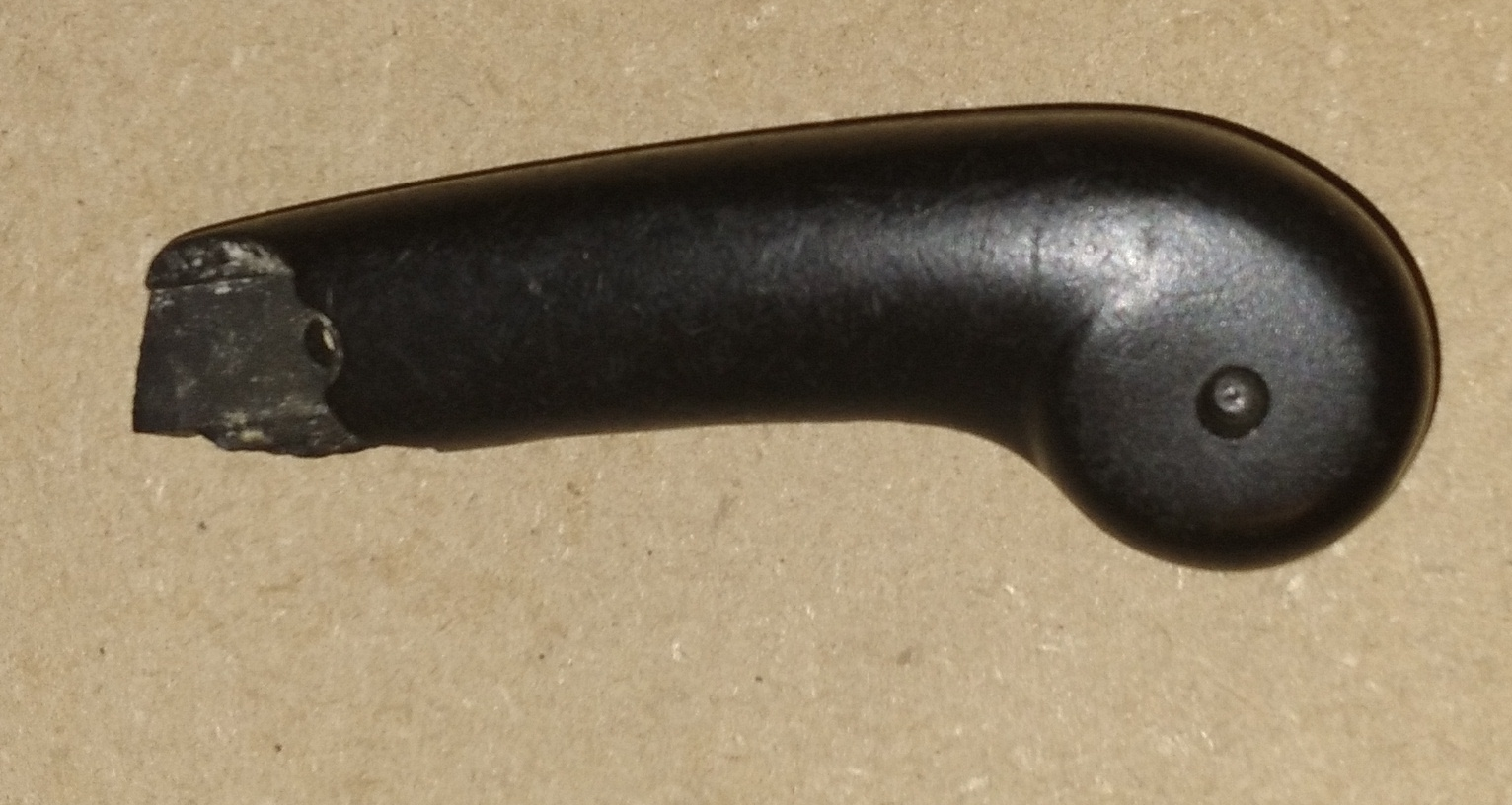

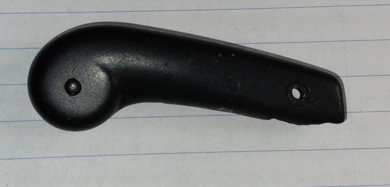

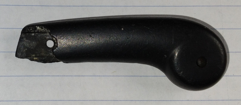

I am trying to replicate a handle for a metal measuring cup that is
designed to look like a saucepan.
Attached is a picture of the handle. It's broken, but there's enough of
it left to let me see what it should look like.
I started off making a sphere in OpenSCAD, and used Inkscape to trace a
bitmap using the picture. I then imported the trace.
Attached is the OpenSCAD file that I have so far.
I'm am at a loss to figure out what to do next.
What I am trying to do is to make the upper right corner of the main
handle 11.5 mm high, and have it taper down to about 5mm high, centred
on the sphere,and maintaining a rounded edge.
My first problem is that I can't seem to linear_extrude the figure to
11.5mm. I have tried extruding the figure itself, before applying
projection(), but could not make that work.
I get the feeling that the right thing to do would be to use sweep()
following the path from the upper right to lower left corners, while
decreasing the height. Unfortunately, sweep() just baffles me.
If you comment out the '//left(47) fwd(16)' you'll see where I want the
end result to be.
Any guidance would be appreciated.

When you import an svg, you will get a 2d shape. When you linear_extrude() it, you will go from 2d to 3d. When you projection(), you will go from 3d to 2d. You will end up where you started.
What is the intention of
projection() linear_extrude() import("svg.svg")
You will likely send your dev-pic.svg; As a general advice: Traced bitmaps may contain a lot of corners. I tried tracing dev-pic.png in Inkscape - it containes a lot of noise on the white background and your target shape ends up hollow. So I repainted the outline with Inkscapes primitives (sphere, rectangle, path->union) as well as a few corners moved by hand. You may use it if you like it. It is attached.

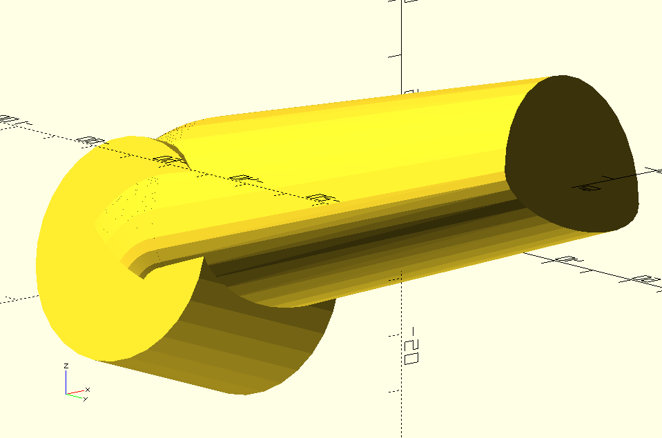

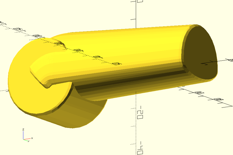

It was the only way I could get ANY linear extrusion at all. However,
after reading your post and trying the files you provided, I found my
error.
I had the scale and linear_extrude switched, so it did the
linear_extrude, but the amount of the extrusion made it look like a 2D
object.
So now it looks like:
linear_extrude(11.5) scale([.097,.097,0])
# import("/media/larry/Modata/make/3d/OpenSCAD/del-pic2.svg");
Thank you very much for pointing out the problem with 'trace bitmap'.
I will now just import the image to Inkscape and use bezier curves to
'trace' the picture, delete the bitmap, resize the path, and save it
for importing to OpenSCAD.
Being fully confident that I can do that, I now come back to my main
question; how can I make the upper right corner start off the same
height and rounded like the cylinder, then moving along the path of the
figure counter-clockwise, smoothly decrease the height to about 7mm?
attached.

I would think in terms of joining together a number of Bézier patches,
but it wouldn't be fun.
https://github.com/BelfrySCAD/BOSL2/wiki/Topics#bezier-patches
I would think in terms of joining together a number of Bézier patches, but it wouldn't be fun. https://github.com/BelfrySCAD/BOSL2/wiki/Topics#bezier-patches
Wed, May 22, 2024 12:42 AM
It seems like you could get a shape somewhat like that by using a
path_sweep with a scale argument to shrink it in one axis along its
length.  You might be able to even get the rounding at the rounded end by
scaling down at that end as well if you give a scale at every point in the
path.

Dear Larry,
It is not obvious to me  what the final shape is supposed to look like.
It is not clear to me from the picture where the handle attaches to its pot.
Maybe you care about other properties such as printing on an FDM printer, in which case a flat surface for the printing bed would be required.
If you want to have a functioning handle, use a cylinder.
If you want to have a fancy rounded surface item, draw a through-cut surface. Use this surface with
hull()
I attached an example of that approach. The cut-through-surface is called
droplet()
I modelled the handle as two half ellipsis.
Even the circular cylinder-like-shape can be approximated with hull() oder minkowski().
You need to supply what properties are important to you (needs to attach to pot with screw size X at point y, I fear scratching my palm when touching the handle close to the screw) and then simplify the object as much as possible.
WARNING: handle.scad is very CPU intense, try handle2.scad first!

For "soft" shapes like these I make use of a hullSeries() module to do
hull() operations stepwise.
Maybe of use.
Regards

pot for cooking, but is a 1 cup measuring cup. The left hole takes a
metal ring to act as a hanger, and the right hole had a rivet to attach
to a tang on the metal 'pot'. I'll be using a very short 3 or 4mm
screw, and possibly a nut. A rectangular cavity at the screw end will
take the tang.
required.
I will be making the edge to the right of the rivet hole flat, which
will print just fine with a brim.
I'd like to replicate the original as close as possible. It has
sentimental value for the one I am making it for.
I was hoping to use path-sweep() to generate the part to be attached to
the cylinder, and I (finally) realized that my initial idea was wrong,
and that I need to use a profile that scales from the cylinder to the
screw end.
Here's a profile that (when scaled), should do the trick.
$fn=60;
projection()
hull() {
  sphere(6);
  right(24) sphere(4);
However, I am at a loss as to how I can generate the path.
Thanks for the help.
