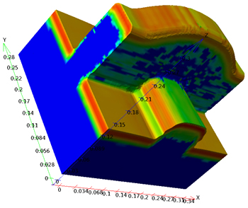

Hello,
Is it possible to create a layer that conforms to the topology of a
surface below it? For example, the top layer in the attached picture has
the same thickness all across but conforms to the surface beneath. Any
suggestion is appreciated.

The operation you want is called "shell" and it can be implemented using
minkowski sum.
http://jweoblog.com/?p=644
This will "create a layer that conforms ..." but it won't "deform" an
existing shape to match the surface topology of another shape.

That works. Thanks Doug!
