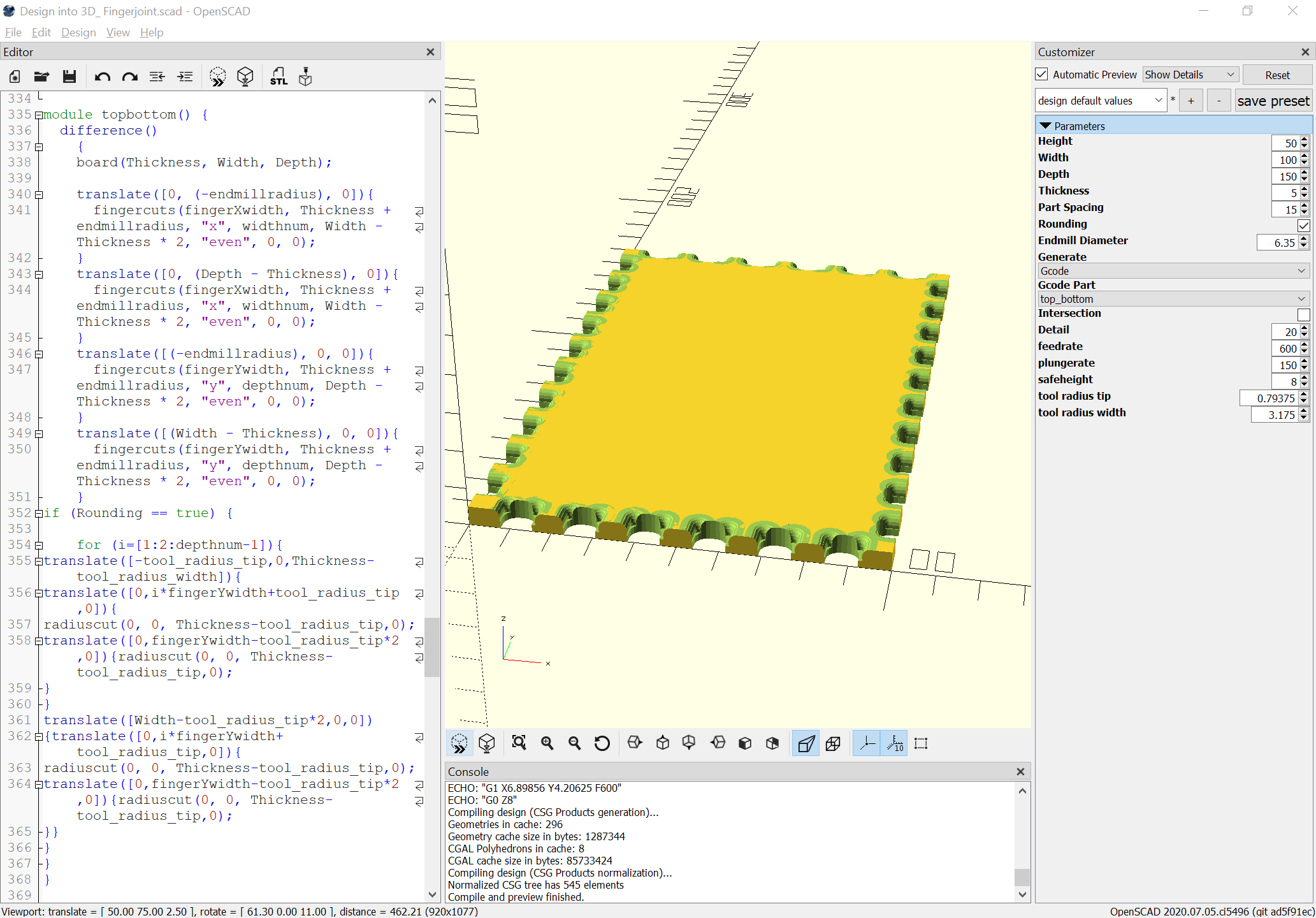

Managed to model a finger joint box with relieved fingers --- now how to actually cut it? Allow OpenSCAD to write out files?
Ray West
Fri, Aug 14, 2020 7:59 PM
Hi, William,
On 14/08/2020 19:10, William F. Adams via Discuss wrote:
Have you actually made a sketch of how a couple of the fingers,
say, actually mesh together, when prepared by what ever router bits
you can use?
Yes, see the links in my previous message.
Please give a link to where you have sketched the shape of the fingers,
and how they mesh, being capable of being produced by standard router
bits, perpendicular to the surface of the wood. i.e. in the sort of
machine that i thought you were intending to use - a flat bed cnc
router. I am not talking about your openscad drawing showing a few sides
that seem to be able to interlock, but where you have actually looked at
the final detailed shape of the individual fingers, and how you will
machine them. Afaik, this is not possible on a flat bed router, unless
you mess around standing them on edge, in which case it then becomes a
trivial problem (other than the work holding), or you're happy to use
gap filling glue.
You say you have designed a joinery system, well if it involves a four
or five axis bed/spindle, you will be in with a chance, but if only
three, then no chance, unless you go for two or more operations. I
suppose a cnc version of the edge milling box joint jigs may do, but
that is not a challenge. There is probably a reason why there is no cam
programs that will do what you want, after all, finger joints are pretty
popular, but already covered by various mechanical jigs. There are,
however, laser cutting cnc systems for finger joints, if you want to see
burn marks on the edges.
If you were to standardise on the minimum gap between the fingers, then
a design for a small mortiser would be interesting, and you'd get square
corners.
Best wishes,
Ray

WF
William F. Adams
Fri, Aug 14, 2020 8:37 PM
Ray West asked:
Please give a link to where you have sketched the shape of the fingers, and how they mesh,
being capable of being produced by standard router bits, perpendicular to the surface of the wood.
i.e. in the sort of machine that i thought you were intending to use - a flat bed cnc router.
Please see: https://community.carbide3d.com/t/cnc-finger-joint-box/8880/113?u=willadams and the posts above/below that.
You can see the details of the radiusing tool definition at: https://community.carbide3d.com/t/design-into-3d-boxes-magazine-storage/16238/54?u=willadams
I've also done a diagonal relief using a V endmill which worked surprisingly well:
https://community.carbide3d.com/t/design-into-3d-boxes-magazine-storage/16238/16?u=willadams
I am not talking about your openscad drawing showing a few sides that seem to be able to interlock,
but where you have actually looked at the final detailed shape of the individual fingers, and how you will machine them.
Afaik, this is not possible on a flat bed router, unless you mess around standing them on edge,
in which case it then becomes a trivial problem (other than the work holding), or you're happy to use gap filling glue.
I've done them standing on edge. It's a tedious pain.
You say you have designed a joinery system, well if it involves a four or five axis bed/spindle, >you will be in with a chance, but if only three, then no chance, unless you go for two or more operations.
Yes, to two or more operations if you consider a tool change an operation, but only one setup.
I suppose a cnc version of the edge milling box joint jigs may do, but that is not a challenge.
Agreed, been there done that.
There is probably a reason why there is no cam programs that will do what you want, after all, >finger joints are pretty popular, but already covered by various mechanical jigs. >There are, however, laser cutting cnc systems for finger joints, if you want to see burn marks on the edges.
I've used generators intended for lasers as a starting point for some projects, but no interest in a laser --- agree that the burn marks look ghastly.
If you were to standardise on the minimum gap between the fingers, then a design for a small mortiser would be interesting, >and you'd get square corners.
Not sure what you mean by that.

Ray West
Fri, Aug 14, 2020 10:12 PM
Thanks, William. I now see we are both right. Your quadrant table is the
fourth axis, in effect. Seems you've had a few arguments elsewhere, too.
A mortiser tool bit is basically a square tube, with sharp edge at the
bottom, and a drill running through the centre. The drill clears the
majority of the chips, leaving a thin ridge and corners for the tube to
shave off. It basically drills square holes in wood. If you rigged up a
similar unit, but with a cnc controlled x/y table to move the wood
around, then it could profile nice square notches. It would most likely
need more pressure than is capable to be exerted by the z axis drive of
the usual cnc routers, however, but there are ways around that.
If you knew someone who could harden and temper tool steel (It is quite
easy), then drill a  hole lengthwise through a steel bar, and
countersink the end (It'll give a sharp edge), then use an ordinary
auger bit in the centrer. You will need to cut away part of the side of
the bar, to let the chips escape. Or you can buy them ready made, of course.
If you limit the size of material you want to process, then you can
build a sturdy gantry type flat bed cnc router, with a beefier z drive
stepper and ball screw. A sharp bit, say 0.25 inch square will not take
much force to push it through most woods. It will not be particularly
fast, especially if you are doing all the cutting with the mortise bit,
but there should be little further processing required.
A bonus would be that you could use openscad to design the machine.

Proof of concept for this: https://community.carbide3d.com/uploads/short-url/Av8DyvPseArwbfWZcxKOLhoFQBW.zip
Parsing design (AST generation)...Saved backup file: C:/Users/willa/OneDrive/Documents/OpenSCAD/backups/Design into 3D_ Fingerjoint-backup-vaTVHyKD.scad
ECHO: "G0 X,", 0, " Y", 0, " Z", 8ECHO: "G1 Z", -3.175, " F", 150ECHO: "G1 X", 0, " Y", 4.20625, " F", 600ECHO: "G0 Z", 8ECHO: "G0 X,", 9.5875, " Y", 0, " Z", 8ECHO: "G1 Z", -3.175, " F", 150ECHO: "G1 X", 9.5875, " Y", 4.20625, " F", 600
&c.
see the post at: https://community.carbide3d.com/t/cnc-finger-joint-box/8880/126
So if we just had a command which would write out only the echoed text less the clutter, we'd have a CAM solution for OpenSCAD files which are coded in a style where a declared piece of stock is subtracted from in a fashion which matches how one wants the CNC machine to cut things out.
Proof of concept for this: https://community.carbide3d.com/uploads/short-url/Av8DyvPseArwbfWZcxKOLhoFQBW.zip Parsing design (AST generation)...Saved backup file: C:/Users/willa/OneDrive/Documents/OpenSCAD/backups/Design into 3D_ Fingerjoint-backup-vaTVHyKD.scad Compiling design (CSG Tree generation)... ECHO: "G0 X,", 0, " Y", 0, " Z", 8ECHO: "G1 Z", -3.175, " F", 150ECHO: "G1 X", 0, " Y", 4.20625, " F", 600ECHO: "G0 Z", 8ECHO: "G0 X,", 9.5875, " Y", 0, " Z", 8ECHO: "G1 Z", -3.175, " F", 150ECHO: "G1 X", 9.5875, " Y", 4.20625, " F", 600 &c. see the post at: https://community.carbide3d.com/t/cnc-finger-joint-box/8880/126 So if we just had a command which would write out only the echoed text less the clutter, we'd have a CAM solution for OpenSCAD files which are coded in a style where a declared piece of stock is subtracted from in a fashion which matches how one wants the CNC machine to cut things out. William

Yes, as noted, that was just a proof of concept. I'll be doing some actual cutting/testing with this today.
I've since found that wrapping things up in str() so as to convert to a string as part of the echo() command cleans up the internal double quotes and commas, so the find-replace and filtering is now trivial (parse each line and only write out those which begin w/ ECHO, just without that text or the colon or the quotes).
So, could we please just get a command which would do that with a user configurable file extension?

I posted my source code at:
https://community.carbide3d.com/uploads/short-url/36SA8hMSvesRwUOKFocbbdxQmrl.zip
in the message: https://community.carbide3d.com/t/cnc-finger-joint-box/8880/126
and I've attached the current copy to this message.
