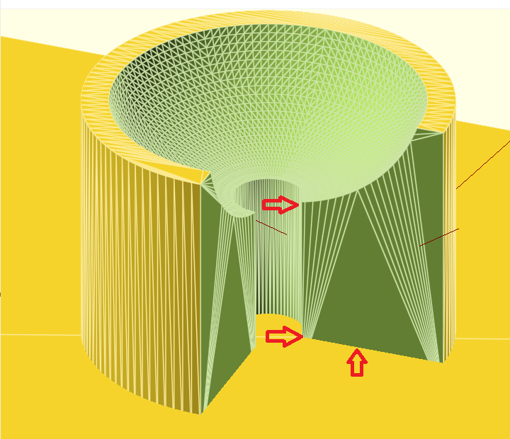

I tried to use the measurement tool to measure the height between the
two left arrows.  There is a measurable point at the top, but no
measurable point at the bottom, nor is there a line to grab.
I isolated the relevant code, and the above "bug" disappears: the bottom
measurable point is now available.  Here is that code:

And here is the original code, where the "bug" exists.  I am puzzled at
the difference.

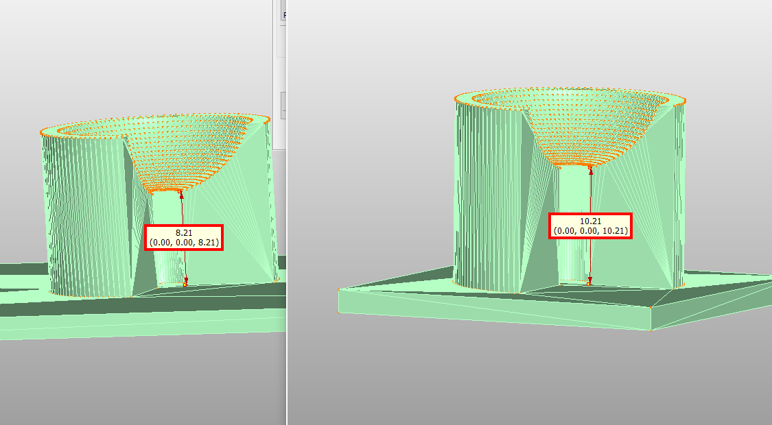

May or may not help you, I did an STL of both examples and used a different
program (3D Tool, Free) to measure.
I am running plain vanilla OpenSCAD V2021.0.1 and the BOSL is june'23

Thank you, Michael.  I use 3D Tool for measurement, too.  I was trying to point out an anomaly.  Perhaps I should create an Issue out of it, but I wanted some feedback first.

Yes.  In my "production" code (bottom in my original post), here, the diamond appears at the top but not at the bottom; in the trimmed down example code (top in my original post), the bottom diamond appears.  My point was that 1) the diamond is not appearing in what seems like an obvious location, and B) the two sets of code seem too similar for them to behave differently as to the diamonds.

I don't doubt you, just reporting that on your "fails for me" example it
works for me.  I am, however, not able to select any of the lines around
the base of that curved subassembly; I am only able to select the vertexes.
I should have noted that I tested on 2026.04.26.
