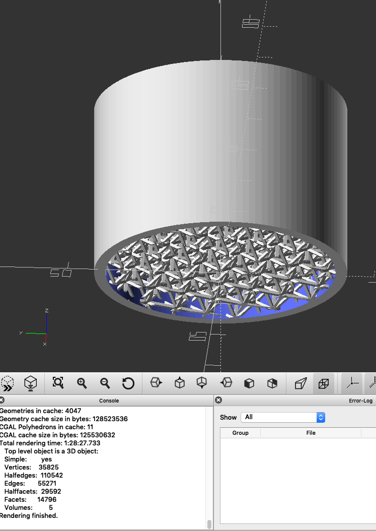

I am trying make a model of something that is essentially a tube (ie a
hollow cylinder) with a lattice structure inside the tube.
I wrote a module that can create a lattice (using long, thin "cube"s) , and
did the following test
cylinder(d=33,h=23,$fn=120); // bigger shorter cylinder
translate([0,0,-1]) cylinder(d=30,h=25,$fn=120); // smaller taller
cylinder, offset to pierce the above
cubicXLattice(); // sized bigger than either

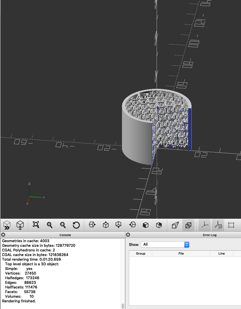

The rendered result has 5 volumes, despite the render of the tube having 2
(its surface and the universe). I then cut into it by subtracting a cube
from it, and the result had 10 volumes. Is there any way to interpret this
other than that the lattice is flawed somehow - that it somehow isn't one
volume (despite being made up simply of many intersecting cubes, and
despite the render of the lattice alone reporting 2 volumes)?
having 2 (its surface and the universe). I then cut into it by
subtracting a cube from it, and the result had 10 volumes. Is there
any way to interpret this other than that the lattice is flawed
somehow - that it somehow isn't one volume (despite being made up
simply of many intersecting cubes, and despite the render of the
Absent the full model source I can't experiment, but I have a guess or two.
Guess #1:  where the lattice touches the shell, there may in some cases
be small enclosed voids.
Guess #2:  in corner cases where you chop the lattice off, there might
be small orphaned objects.
Guess #3:  Computational imprecision (e.g. the fact that cylinders are
really polygonal, or that floating point values are not precise) might
be throwing a wrench into the works.
The A-(B-C) structure that you've used is somewhat hard to reason about
when the objects are not simple.  I assume that you're doing it at least
partially to cut the lattice into a cylinder.
You might try instead something like
id = 9;
od = 10;
overlap = 0.2;
h = 10;
    cylinder(h=h, d=od);
    cylinder(h=h*3, d=id, center=true);
    lattice();
    cylinder(h=h, d=id + overlap);
which makes a tube of the specified height with the specified inside and
outside diameters, and then cuts a lattice to the right height and a
little bigger than the ID so that it will cleanly overlap with the tube.
But also:  other than curiosity, why do you care?

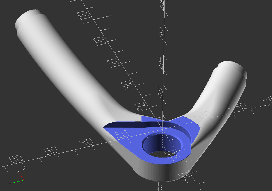

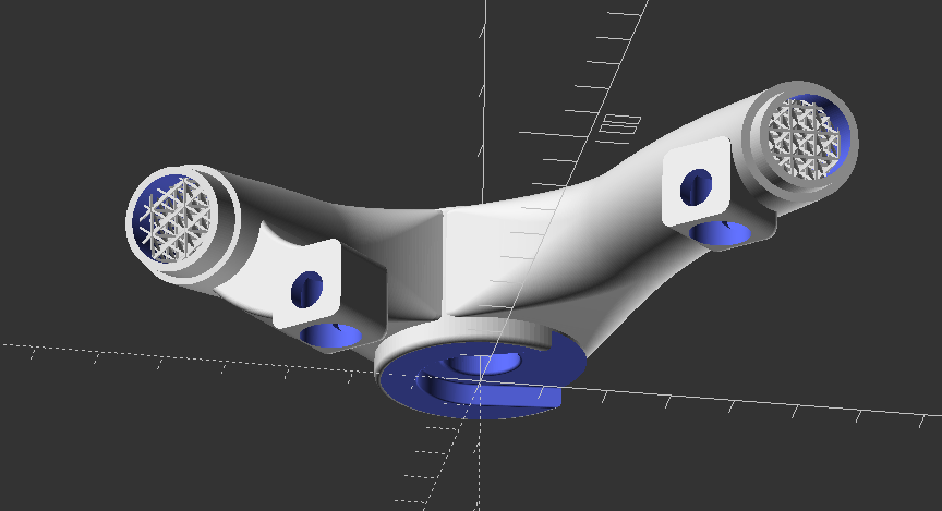

The back-story is that I am designing some bicycle frame parts to have 3D
printed from titanium using DMLS and then welded into a frame (in
preference to a machined part). The company that will do the printing
ordinarily works with STP files, and then has a workflow that involves
taking a solid design, introducing wall thickness and structural / internal
support in SolidWorks (eg braces inside tubes), and then adding external
sacrificial structural support to stop the part pulling off the build plate.
But I am more experienced working from an openscad / source-code approach
than trying to design in a GUI, especially when trying to create and
control complex shapes. And before I understood the company's workflow, I
had already created my designs. One of the main components of the designs
are bent tubes that may transition in their cross-sectional shape: each
cross section is part of a "rounded off rectangle" family (encompasses
regular circles). To do this I am creating the points and faces of a
polyhedron via iteration and recursion - the hollow cylinder in the example
is a simple representation of the more complex concept, but demonstrates
some of the same issues. Ultimately, I am trying to reproduce the company's
workflow on the models myself - make them hollow, add internal structure to
make them stronger, etc - given that they cannot perform their regular
workflow on an STL file that openscad produces. I also like the idea of
being able to follow and control the project / design through all phases
myself.

On Sat, May 28, 2022 at 11:02 PM Jordan Brown openscad@jordan.maileater.net
Guess #1:  where the lattice touches the shell, there may in some cases be
Guess #2:  in corner cases where you chop the lattice off, there might be
really polygonal, or that floating point values are not precise) might be
id = 9;
od = 10;
overlap = 0.2;
h = 10;
lattice();
outside diameters, and then cuts a lattice to the right height and a little

are OK.
But repeating this task of cutting into the models, multiple times, by
doing full renders is time-consuming, so I decided to try doing the
checking operations by: difference() {import(part_model.stl);
cutting_cube(); }.
For the larger/more complex two out of three parts, CGAL finds faults
with the imported STL object, and that has left me with an uneasy feeling
about them that I have been trying to investigate and resolve.The oddity of
the volume number made me pursue this line of investigation, but it might
be a red-herring.
The lattice code I linked to above provides a good example of the
problems I am having. I believe that if you run it, it will create a valid
object with two volumes - a tube supported by an internal lattice. But, at
least in my case, if you save it to an STL, and then import it, and
subtract a cube from it, it will give CGAL errors about CGAL_Nef_Polyhedron.
The CGAL errors from the STL imports have been really troublesome to
investigate. I have played games where I slowly build up the parts from a
simple starting state - take out the lattice, other complex details, make
them no longer hollow...then add these things back in. By doing this I will
get an STL that I can import and modify - and think I am onto something -
but then I will add a detail, run into a CGAL error, and back up to the
prior state that had worked and find that it suddenly no longer does (ie I
try to recreate the previously successful model and save a new STL, and the
new STL will cause CGAL errors after import and modify that the old did
not).
The bottom line here is that I am unsure whether these problems I am
having with the STL import should be cause for concern with the models
themselves, or are just a result of minor floating point issues that stem
from re-reading of a file (rather than using a value stored in memory that
is consistent with the original creation of said file).
No doubt the fact that each polyhedron has 60 steps along its length, and
120 segments around it, is contributing to these issues... not to mention
the large lattice. But I obviously don't want to see facets in the parts
that are made, and want a fine lattice to provide uniform structure.
Would greatly appreciate your further insight. Photos of the rendered
parts attached also.
[image: Messages Image(1539228526).png]
[image: Messages Image(2485843806).png]
On Sat, May 28, 2022 at 11:02 PM Jordan Brown <
2 (its surface and the universe). I then cut into it by subtracting a cube
two.
id = 9;
od = 10;
overlap = 0.2;
h = 10;
lattice();
