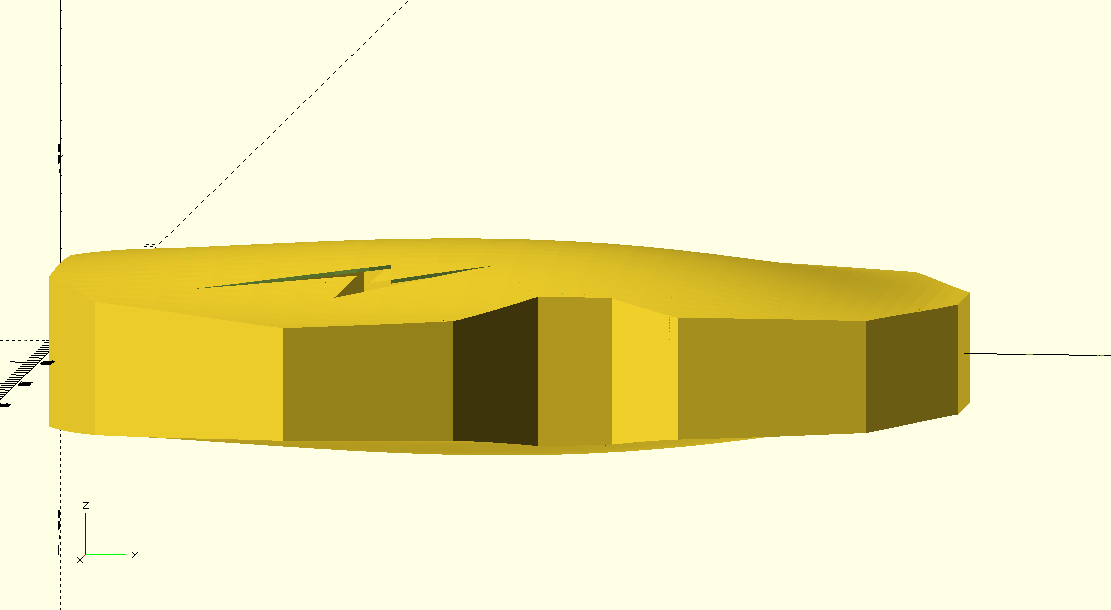

I want to build surface of violin.

Got it, made partially but
I want to connect two mirrored surfaces to make it solid then diff with target form.
Howto connect? simply append second point list?

I mirrored with zero Z
Do they share boundary edges
but still cannot vnf_join both polyhedrons
What I do wrong?

Using your original version you can build a surface like this:
vnf = vnf_vertex_array(pts, style=style,reverse=true);
vnf2 = zflip(vnf);
v = vnf_join([vnf,vnf2]);
vnf_polyhedron(v);
Note that reverse is needed because your made your faces backwards.  The
way to tell this is to select "thrown together" as the rendering method
(instead of preview) and use F5.  If your object is entirely yellow you're
OK.  If you see any purple, those parts are backwards.  An object is only
valid if it's entirely yellow.  (And this won't work if you apply your own
color.)  If you want to use this method for a violin you'll also need to
construct with vnf_verte_array the strip that connects the two halves.
Another option that might be less work would be to use textured_tile()
which can accept your points and put them on a cuboid for you, so it
creates the other faces.  That will only work if your points exist on a
grid in (x,y) though.

Thank you! I did it.
