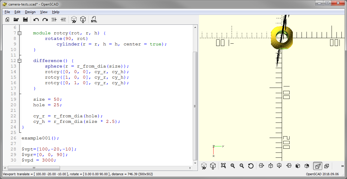

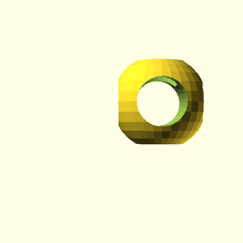

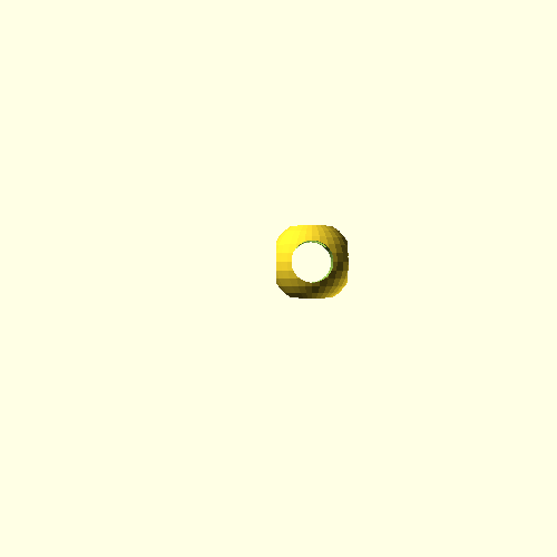

Unifying the camera modes has revealed another bug. This test now fails but
the actual image is correct in my opinion.
openscad-camtrans-viewall_camera-tests
Expected image Actual image
It tests the gimbal camera with viewall without auto center, something
that only can happen with the command line. The camera is translated a
long way from the object's center (which is on the origin), mainly in
the X direction and it is looking down the X axis, so most of of that
offset is not apparent.
The viewall logic is that the object should remain visible with any
camera rotation so it needs to view from quiet far away.
It doesn't work with the old code because it uses Camera::center,
which is not set in the gimbal camera unless auto centre is also set
(it always is in the GUI). I.e. that was the bug I fixed recently, but
it only fixed it when auto center is set.
I hacked the GUI to not set autocentre and you can see the distance is
appropriate when the camera is rotated so that the X translation is
visible.

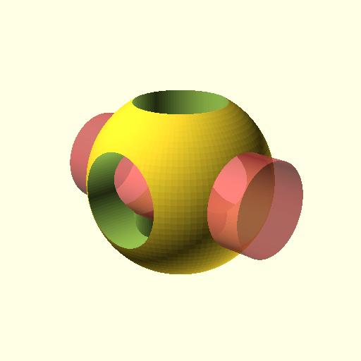

I regenerated the test images for the corrected lighting with
TEST_GENERATE=1 and it works for all the tests except this one:
Image tests
openscad-colorscheme-cornfield-alphafail_logo
1090/1124 Testing: openscad-colorscheme-cornfield-alphafail_logo
1090/1124 Test: openscad-colorscheme-cornfield-alphafail_logo

Looking at the difference on Github here:
https://github.com/nophead/openscad/commit/a75d9596ac85d6730a9d1658e76efa4871fa47ec?short_path=d08cf42#diff-7a2e4b520807a0b305be99f2fcb77915
I can see that the original expected result had alpha in it but the file I
have generated does not.

Now I am totally confused. Why would an image generated with the default
Cornfield colorscheme be expected to have a transparent background?
Why, when I changed the expected background to be not transparent, did it
not make the test pass anyway?

but the actual image is correct in my opinion.
It tests the gimbal camera with viewall without auto center, something that only can happen with the command line. The camera is translated a long way from the object's center (which is on the origin), mainly in the X direction and it is looking down the X axis, so most of of that offset is not apparent.
The viewall logic is that the object should remain visible with any camera rotation so it needs to view from quiet far away.
It doesn't work with the old code because it uses Camera::center, which is not set in the gimbal camera unless auto centre is also set (it always is in the GUI). I.e. that was the bug I fixed recently, but it only fixed it when auto center is set.
I hacked the GUI to not set autocentre and you can see the distance is appropriate when the camera is rotated so that the X translation is visible.
