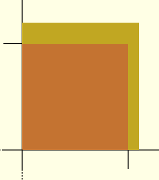

Here's one way to look at it, in 2D:  you have shape A.  You have a
paintbrush in the shape of B.  Drag the paintbrush around the entire
perimeter of A, keeping the origin of the paintbrush on A's outline.
3D is similar, but with a harder-to-imagine 3D paintbrush.
If B is a circle, then it as you said:  add the radius.  But if B is
other than a circle, or if it's not centered on the origin, the result
is different.
Here's a simple non-circle, not-centered example:
minkowski() {
     #square(10);
     square([1,2]);
In the picture below, the orange-ish is the original ten-unit square,
and the gold is the part that gets added.  Note that because the second
square is entirely up and right of the origin, stuff is added only to
the top right, and because the second square is taller than it is wide,
more is added on the top than on the right.

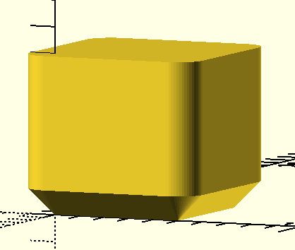

In 3D you can get useful effects from this, e.g. by adding a cone.
$fa = 1;
$fs = 1;
minkowski() {
     cube(50);
     cylinder(h=10, r1=0, r2=10);
