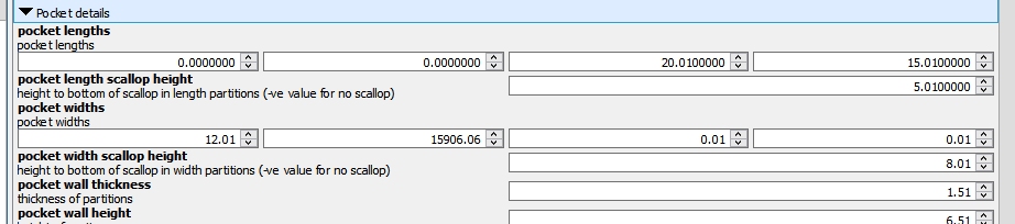

Thu, Nov 2, 2023 9:01 PM
Someone has updated the documentation, wrt not working in later
versions, so thanks.
How  can I fix or allow decimal points. I have some fields that if set
to 0 shows 0.0000000 on leaving, others t I can't enter a decimal point.
some I managed to get to allow two digits after the dp, by setting the
default to 2dp's. as below
/[ Pocket details]/
// pocket lengths
pocket_lengths = [10.01,12.01,20.01,15.01];
// height to bottom of scallop in length partitions (-ve value for no
scallop)
pocket_length_scallop_height = 5.01;
// pocket widths
pocket_widths = [12.01,10.01,0.01,0.01];
// height to bottom of scallop in width partitions (-ve value for no
scallop)
pocket_width_scallop_height = 8.01;
but In the customizer I get
I've flushed cache, restarted openscad, but still these odd results. Any
ideas?
wrt moving the panels, they seem to snap to a location and resize
whenever I move near another panel.

Fri, Nov 3, 2023 11:07 PM
I think that's a known weakness.
I don't have any suggestions.

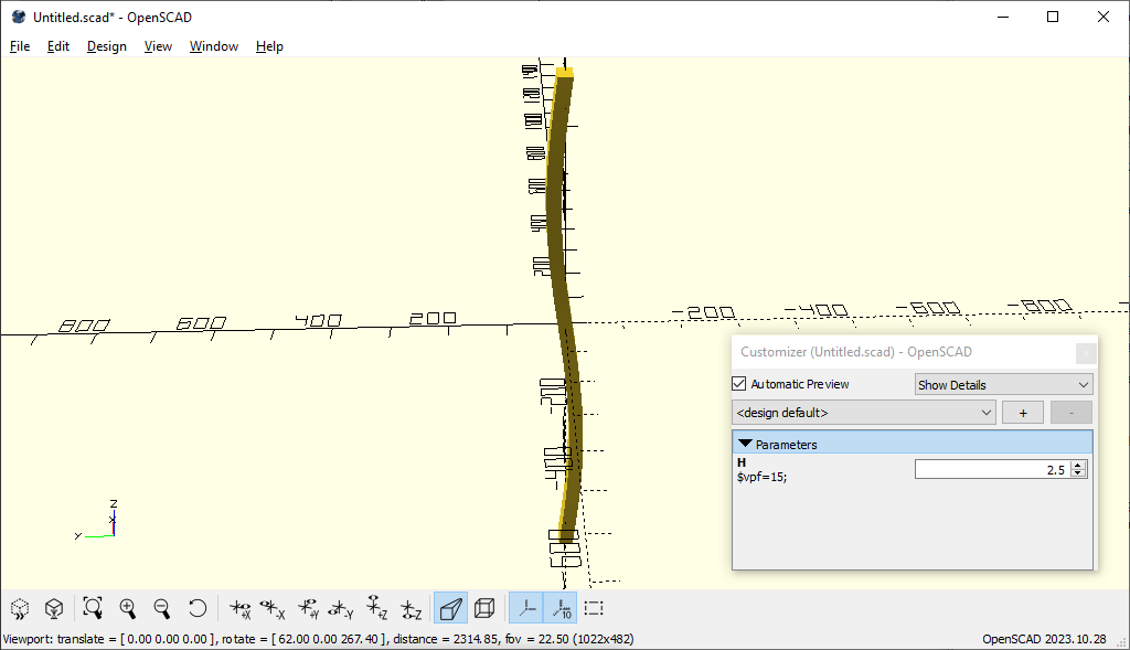

If you set the "Enable undocking" option, you can move the pane around
freely; it only snaps when you put it near the edge of the window.  (And
once it snaps, you can only resize in one axis.)
For instance:
On 11/2/2023 2:01 PM, Raymond West wrote: > > How  can I fix or allow decimal points. > I think that's a known weakness. * Do not constrain the precision of manually entered numeric values in customizer <https://github.com/openscad/openscad/issues/3315> * Openscad Customizer Improvements <https://github.com/openscad/openscad/issues/1781> (second-to-last item) * Allow to set the number of decimals in customizer <https://github.com/openscad/openscad/issues/3098> I don't have any suggestions. > wrt moving the panels, they seem to snap to a location and resize > whenever I move near another panel. > If you set the "Enable undocking" option, you can move the pane around freely; it only snaps when you put it near the edge of the window.  (And once it snaps, you can only resize in one axis.) For instance:
