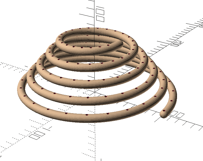

How make this flat instead of a cylinder

I used an AI system to create this, it is for the most part exactly what I what but instead of it being a sphere going around and up I want it to be a flat bar the same size as the sphere.  Any easy way of doing this?

I didn't try out your code, but it looks like you should replace sphere()
twice in module spiral() with cube().  To be closer to a perfect flat bar,
you would need to x-rotate (or possibly y-rotate) the cube() by the value
of angle in module spiral_points().

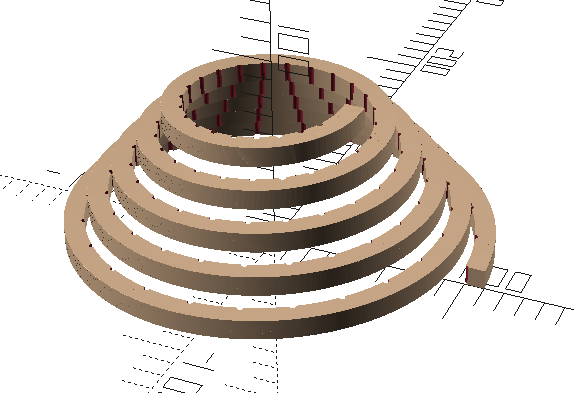

I tried cube() and it was close and probably rotating it like you mentioned would fix it.

My first thought it to change the two spheres to cube(5,true), in module
spiral, which sort of works, if it a rectangular cross section that you
want for the 'wire' instead of round. but there are oddities with the
smoothness of the spiral curve. I haven't looked into it further.

Rotating the cube was the trick to make it work I had to rotate it on the Z axis.  Doing that somehow messed up the hole placement so I will have to fix that part now.

My method for drawing springs, threads, and similar spirals, is to make
a profile in 2d, extrude it, say 0.5mm, then rotate it, and translate it
in x, the overall radius, then within in a  for loop, rotate it and
translate in z a small amount. The hull will smooth it out, but I've
never bothered  with that. As this 'spring' is tapered, then also alter
the translate value  within the loop.
doing this?
Here is the code it generated, I modified this a little bit.
// Parameters
num_points=500;
initial_diameter = 200;  // base diameter
height = 75;  // Total height (3 rounds × 25mm per round)
diameter_decrease = 25;  // 25mm decrease per round
num_holes = 120;
spiral_thickness = 10;  // Thickness of the spiral path
hole_diameter = 3;  // 3mm holes
// Function to calculate points along the spiral
function spiral_points(steps) = [
    for(i = [0:steps-1])
    let(
        angle = i * 360 * 5 / steps,  // 5 complete rotations
        radius = (initial_diameter - (angle/360) * diameter_decrease) / 2,
        z = (height * angle) / (360 * 5)
        radius * cos(angle),
        radius * sin(angle),
        z
// Function to create points for a hole at a given position and normal
function rotate_points(points, normal, center) =
    let(
        angle = atan2(normal[1], normal[0]),
        elevation = atan2(normal[2], sqrt(normal[0] * normal[0] +
normal[1] * normal[1]))
        for(p = points)
        let(
            rotated =
                [[1, 0, 0], [0, cos(elevation), -sin(elevation)], [0,
sin(elevation), cos(elevation)]] *
                [[cos(angle), -sin(angle), 0], [sin(angle),
cos(angle), 0], [0, 0, 1]] *
                p
            rotated[0] + center[0],
            rotated[1] + center[1],
            rotated[2] + center[2]
// Create the main spiral
module spiral() {
    points = spiral_points(num_points);  // Generate 500 points along
the spiral
    // Create the spiral path
    for(i = [0:len(points)-2]) {
        hull() {
            translate(points[i])
                sphere(d=spiral_thickness, $fn=20);
            translate(points[i+1])
// Create holes along the spiral
module holes() {
    points = spiral_points(num_holes);
        // Calculate direction vector for hole orientation
        vector = points[i+1] - points[i];
        length = norm(vector);
        normal = vector / length;
        // Create hole
        translate(points[i]) {
            // Create a cylinder oriented along the normal vector
            hole_points = rotate_points(
                [for(z = [-15:15]) [0, 0, z]],
                normal,
                [0, 0, 0]
            hull() {
                for(p = hole_points) {
                    translate(p)
sphere(d=hole_diameter, $fn=16);
// Final model
    spiral();
    holes();

My method for drawing springs, threads, and similar spirals, is to make a profile in 2d, extrude it, say 0.5mm, then rotate it, and translate it in x, the overall radius, then within in a  for loop, rotate it and translate in z a small amount. The hull will smooth it out, but I've never bothered  with that. As this 'spring' is tapered, then also alter the translate value  within the loop. On 12/01/2025 22:27, Trevor Orr via Discuss wrote: > Rotating the cube was the trick to make it work I had to rotate it on > the Z axis.  Doing that somehow messed up the hole placement so I will > have to fix that part now. > > > // Create the main spiral > module spiral() { >     points = spiral_points(num_points);  // Generate 500 points along > the spiral >     // Create the spiral path >     for(i = [0:len(points)-2]) { > angle = i * 360 * 5 / len(points); >         hull() { >             translate(points[i]) >                 //sphere(d=spiral_thickness, $fn=20); > rotate([0, 0, angle]) > cube([spiral_thickness, 1, spiral_thickness]); >             translate(points[i+1]) >                 //sphere(d=spiral_thickness, $fn=20); > rotate([0, 0, angle]) > cube([spiral_thickness, 1, spiral_thickness]); >         } >     } > } > > > > > > > > On Sunday, January 12, 2025 at 02:16:06 PM PST, Raymond West via > Discuss <discuss@lists.openscad.org> wrote: > > > My first thought it to change the two spheres to cube(5,true), in > module spiral, which sort of works, if it a rectangular cross section > that you want for the 'wire' instead of round. but there are oddities > with the smoothness of the spiral curve. I haven't looked into it further. > > On 12/01/2025 21:34, Trevor Orr via Discuss wrote: > I used an AI system to create this, it is for the most part exactly > what I what but instead of it being a sphere going around and up I > want it to be a flat bar the same size as the sphere.  Any easy way of > doing this? > > Here is the code it generated, I modified this a little bit. > > > > // Parameters > num_points=500; > initial_diameter = 200;  // base diameter > height = 75;  // Total height (3 rounds × 25mm per round) > diameter_decrease = 25;  // 25mm decrease per round > num_holes = 120; > spiral_thickness = 10;  // Thickness of the spiral path > hole_diameter = 3;  // 3mm holes > > > // Function to calculate points along the spiral > function spiral_points(steps) = [ >     for(i = [0:steps-1]) >     let( >         angle = i * 360 * 5 / steps,  // 5 complete rotations >         radius = (initial_diameter - (angle/360) * diameter_decrease) / 2, >         z = (height * angle) / (360 * 5) >     ) >     [ >         radius * cos(angle), >         radius * sin(angle), >         z >     ] > ]; > > // Function to create points for a hole at a given position and normal > function rotate_points(points, normal, center) = >     let( >         angle = atan2(normal[1], normal[0]), >         elevation = atan2(normal[2], sqrt(normal[0] * normal[0] + > normal[1] * normal[1])) >     ) >     [ >         for(p = points) >         let( >             rotated = >                 [[1, 0, 0], [0, cos(elevation), -sin(elevation)], [0, > sin(elevation), cos(elevation)]] * >                 [[cos(angle), -sin(angle), 0], [sin(angle), > cos(angle), 0], [0, 0, 1]] * >                 p >         ) >         [ >             rotated[0] + center[0], >             rotated[1] + center[1], >             rotated[2] + center[2] >         ] >     ]; > > // Create the main spiral > module spiral() { >     points = spiral_points(num_points);  // Generate 500 points along > the spiral >     // Create the spiral path >     for(i = [0:len(points)-2]) { >         hull() { >             translate(points[i]) >                 sphere(d=spiral_thickness, $fn=20); >             translate(points[i+1]) >                 sphere(d=spiral_thickness, $fn=20); >         } >     } > } > > // Create holes along the spiral > module holes() { >     points = spiral_points(num_holes); >     for(i = [0:len(points)-2]) { >         // Calculate direction vector for hole orientation >         vector = points[i+1] - points[i]; >         length = norm(vector); >         normal = vector / length; >         // Create hole >         translate(points[i]) { >             // Create a cylinder oriented along the normal vector >             hole_points = rotate_points( >                 [for(z = [-15:15]) [0, 0, z]], >                 normal, >                 [0, 0, 0] >             ); >             hull() { >                 for(p = hole_points) { >                     translate(p) > sphere(d=hole_diameter, $fn=16); >                 } >             } >         } >     } > } > > // Final model > difference() { >     spiral(); >     holes(); > } > > > _______________________________________________ > OpenSCAD mailing list > To unsubscribe send an email todiscuss-leave@lists.openscad.org <mailto:discuss-leave@lists.openscad.org> > _______________________________________________ > OpenSCAD mailing list > To unsubscribe send an email to discuss-leave@lists.openscad.org > > _______________________________________________ > OpenSCAD mailing list > To unsubscribe send an email todiscuss-leave@lists.openscad.org
TO
Trevor Orr
Sun, Jan 12, 2025 11:07 PM
That sounds to like it would work better because I could put the holes in
it before the extrude.
On January 12, 2025 2:54:59 PM Raymond West via Discuss
within the loop.
fix that part now.
module spiral() {
points = spiral_points(num_points);  // Generate 500 points along the spiral
hull() {
On Sunday, January 12, 2025 at 02:16:06 PM PST, Raymond West via Discuss
