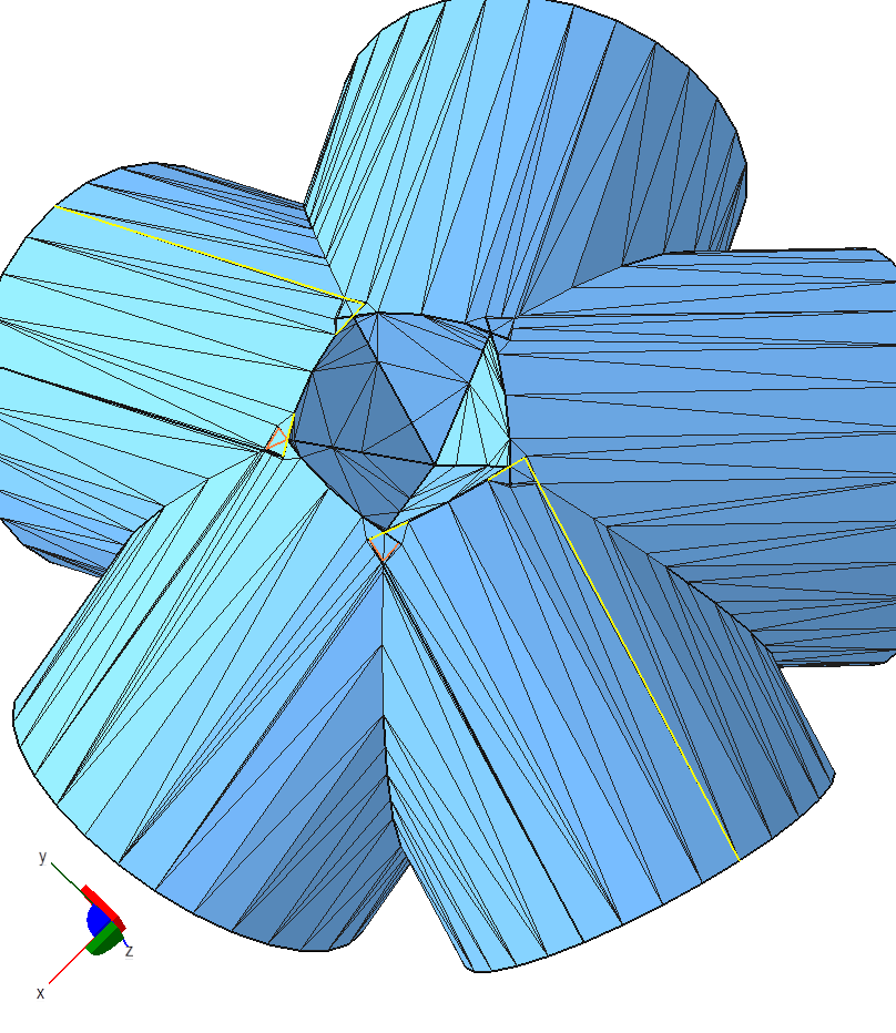

I am experiencing a strange issue where:
  1. My “fast” renders are slow
  2. My “slow” renders are instant but error free
  3. I get an error only when I try to export a particular object.
When I remove the minkowski function it works well. When I add it I only get an error when trying to export the object.
Is this a bug or (more likely) is there something I am missing?

The reason it is slow to preview is because OpenCSG used for preview can't
simulate Minkowski, so it has to be computed geometrically with CGAL. It is
then cached so render is fast.
I think the reason it goes wrong is that the union of the cylinders has
vertices that are too close for OpenSCAD's grid.

Ahh!
I was not at all aware of this grid system. Do you know if any docs on it?
As for the union of cylinders how would you recommend I resolve this? It’s sort of frustrating that there is arbitrary geometry that does not work.
Caitlin

Perhaps rotate each cylinder a little so the facets don't line up exactly.
OpenSCAD has multiple problems with vertices that are very close but not
exactly matching due to rounding errors. CGAL computes with
infinite precision rationals but they get converted to doubles and and
snapped to a fine grid and sometimes a course grid here:
https://github.com/openscad/openscad/blob/master/src/grid.h#L19.  When an
STL is written they get truncated to floats. This is a major design error
because you can't reduce the resolution of vertices without potentially
creating degenerate triangles and self intersections. These need to be
cleaned up after every truncation but that isn't easy.

I don't know if that grid system is the problem in this case, but
booleans can be tricky when the facets line up in ambiguous ways and
that can happen with minkowski. Maybe try with different faceting
resolutions ($fn).

It seems like this issue, about coordinate errors, gets raised a lot to
explain models that aren't working.  And yet, it seems like there's always,
in the end, a different explanation.  I'm not sure I've seen an example of a
model where this was really the problem.  And when I took a look at this
model, my observation is that the result looks very wrong at a large scale.
(Note that when I rendered and exported the model I did not get an error.)
The facets around the holes should be smooth but instead they are kind of
zig-zagging back and forth at a scale that is a billion times bigger than
where rationals are going to round to each other.  (Note for this run I had
$fn=16 in the last call to sphere.)

I didn't look at the minkowski result much because the simple union of the
cylinders in the for loop is already broken when exported to STL. It is
possible for minkowski to heal errors though because it is a union of hulls
and hull doesn't need a manifold, just a point cloud.
I don't use the built in sphere() of OpenSCAD because they tend to be ugly
and that is probably the source of the weirdness at low $fn.

What's wrong with the union of cylinders?  I exported it, loaded it into
PrusaSlicer, sliced it.  Everything appears to be OK---except that it looks
ugly where they meet, with a little artifact there. That artifact is just a
result of the cylinders being polyhedra instead of actually round, so it's
not wrong.
My run with $fn=32 completed in half an hour, and the rounding of the
circular holes still looks wonky, with weird zig-zags in the facets.

According to Netfabb it is broken. The picture I posted above shows where.
