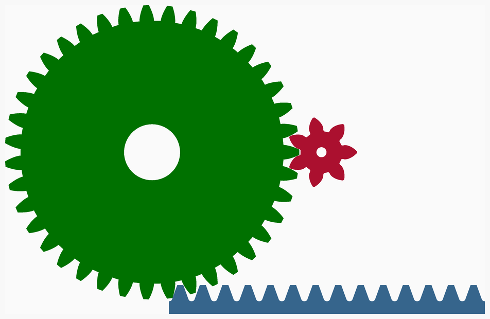

I'm very new to working with gears in OpenSCAD (actually, gears in general), and am trying to learn the BOSL2 gears.scad library (https://github.com/BelfrySCAD/BOSL2/blob/master/gears.scad)
[https://repository-images.githubusercontent.com/182187489/7f60f080-3992-11eb-9baf-22e99510b07f]https://github.com/BelfrySCAD/BOSL2/blob/master/gears.scad
BOSL2/gears.scad at master · BelfrySCAD/BOSL2https://github.com/BelfrySCAD/BOSL2/blob/master/gears.scad
The Belfry OpenScad Library, v2.0. An OpenSCAD library of shapes, masks, and manipulators to make working with OpenSCAD easier. BETA - BelfrySCAD/BOSL2
github.com
I am currently looking at the rack() module, and am trying to figure out the distance between the teeth in the generated rack. There are many functions, and with my limited knowledge and unfamiliarity of some of the terminology, I am having trouble finding the function that does this. Can somebody help me figure out which function (or how to calculate) the distance between the teeth of a rack gear? Thanks!
Nathan Sokalski
njsokalski@hotmail.commailto:njsokalski@hotmail.com
You might have better luck making sense of everything if you start with
circular gears (the normal case) instead of racks, where the terminology
may make less sense. Did you read the section at the top about the way
involute gears work and the associated terminology?
You can specify circ_pitch=x to make the teeth x units wide. Or you can
use the circular_pitch() function to compute it from the module or
diametral pitch. Why do you need to know this number? Is it to determine
the length of your rack?

The reason I want to know this is because I want to position the rack to be aligned with the other gears. It would also be good to know the length of the rack. Something that would be really nice would be a diagram for each gear type containing the different parts and (if applicable) what function can be used to calculate them. I will try to at the involute gears section again to see if it helps me make more sense. I think one of the things confusing me is when the same terminology and/or variable/parameter names are used for round & flat gears. Thanks for your help, hopefully I can get some of it figured out.

Well, maybe this is what was called "quirky" above, but if gear terminology
didn't use the same labels for racks as for round gears you'd be hopelessly
confused if you wanted your rack to actually mate with a round gear. The
teeth need to be the same form for the gears to mate, so the description
should be the same! I don't know what the "different parts" of the gears
are that would appear on the proposed diagram. There's one diagram that
shows different circles. Perhaps circular pitch could be added, but that
seems like it covers things. Since all gears work on the same system, the
pictures of different gears would basically be the same. Maybe it helps a
bit if you think of a rack as a circular gear with infinite diameter. :)
Ideally you shouldn't need to compute gear minutiae but rather should be
able to use more automated schemes to position things the way you need, but
gears are complex enough that making everything automated is impossible due
to things like profile shifting and tip shortening that depends on what the
mating gears are.
Revar is hoping to write gear attachment code that will automatically
position gears relative to other gears with the teeth properly meshing.
But that's a thing for the future. It would definitely be nice to have, as
positioning gears can be a pain.
