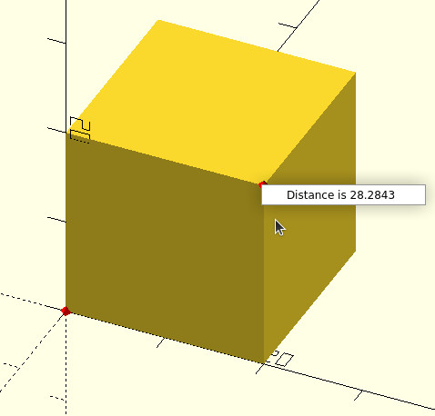

OpenSCAD 2024.8.30 is the latest build available for Windows.
When I click on either the icon or the Menu's, absolutely nothing
happens.  Is there some precursor required in addition to Render?
I don't think so. I'm sort of waiting to see what the dev team folks
say about it. I don't see anything in preferences.
As for a screen shot, (thanks Gene) here's one showing two red dots and
a box with the distance between them. This was obtained by the exact
sequence:
clicked on 'measure' icon
clicked on lower left corner of 20mm cube
clicked on upper right corner of 20mm cube

Should be right on the picture in a little pop-up box.
When you click on the measure icon, then click on a part, you will
either get a line on an edge or a dot on a vertex. Then clicking on
another feature should show a pop-up box.
ESC will exit the measuring state.
I would give you a screenshot, but when I try, the box goes away.
Maybe try a later dev snapshot.
sequence:
Couple comments, 1. probably due to cheap spastic mice. I cannot seem to
place, with my nearly 90 yo hands. the red dots as precisely as shown
below. My system needs a sloewer mouse.
2. the red dots do not disappear even after a fresh render.
