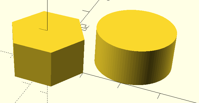

This probably has been discussed here but I can't find it, sorry.
I want to make a hex hole for a nut. I thought just set $fa of a
cylinder for 6 sides. Works great. However my project has $fn=100 and
that over rides it. I need $fn=100 for the rest of it. I tried making it
an external  module but that still gets over written. Is there some way
to define just that one thing different?

You can pass $fn = 6 as an argument to cylinder, e.g.:
$fn = 100;
cylinder(10, 10, 10, $fn=6);
translate([20, 10, 0])
cylinder(10, 10, 10);
[image: Screenshot_20210309_115813.png]

Thanks
I will swear I tried that yesterday and it didn't work. Don't know what
happened but it works now.
Lee
