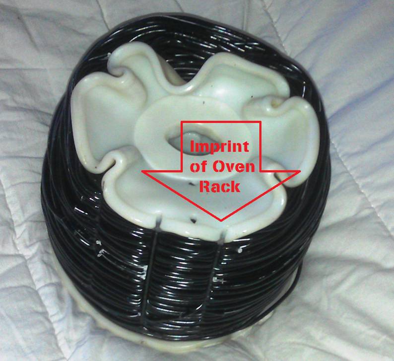

This thread is getting way off-topic for OpenSCAD Support!
But seeing we're here already, and it's slow day at 91-99*%RH & apparent -0.5?C at midday...
I thought it worth sharing on of my early learnin's.
Don't try this at home.
*The other learnin, of you can't see the hills for the fog, apparently that means it is 99%RH.
We get a lot of that about daybreak here. But methinks that roll got a
little too warm. Just a wee bit. :) Which might be considered odd, since
this is wintertime in Oz. At 39 degrees north, our AC's are working
overtime. Not at 3 am tonight, but probably by 10 am.
Oh dear!
Oven with convection would actually be good if you can just keep the
temperature accurate....
I constructed an Arduino with a light sensor, temperature sensor and step
motor (+ knob+display+buzzer) and can control the oven to +-0.5 degree
https://youtu.be/jbKlLoTx0es. My problem is: Arduino freezes after a
while.... so I am at the same, dumb situation as before (and fear the same
result as your foto).
