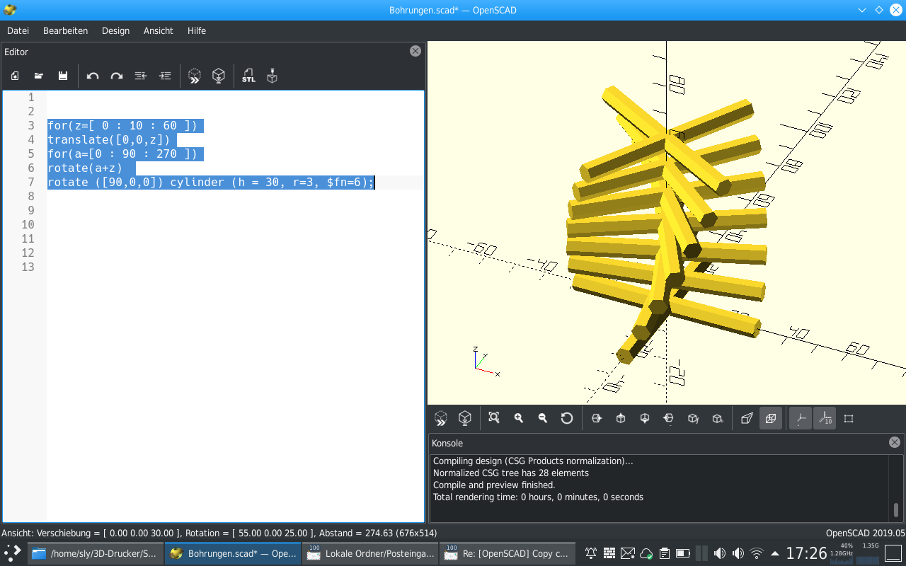

Hello all,
I'm a newbe on openscad.
I want to copy a cylinder around Z then copy it upwards. That's working but
I cannot get a twist in.
The first cylinder is:
module Zylinder ()
{ rotate ([90,0,0]) cylinder (h = 30, r=3 , $fn=6); }
Then I copy it around Z:
module FirstLayer()
{ for(a=[0 : 90 : 270])  rotate(a) Zylinder(); }
Until here it is working. I have 4 Cylinders like a cross.
But how can I copy the whole cross up let's say 20mm and twist it let's say
30° so I have the copied one 30° "twisted"?
Greets

Sorry, I forgot to add this.
for(z=[ 0 : 10 : 10 ])
translate([0,0,z])
for(a=[0 : 90 : 270 ])
rotate(a)
rotate ([90,0,0]) cylinder (h = 30, r=3, $fn=6);
But on the "translated" I would like to have an additional rotation around "Z"
Something like an additional "rotate(b)" but then the lowest cross is also getting this copy.

replace rotate(a) with rotate(a+z*3)

YESSSSSSS !!!!!!!
for(z=[ 0 : 10 : 60 ])
translate([0,0,z])
rotate(a+z)
Now it looks like this:
