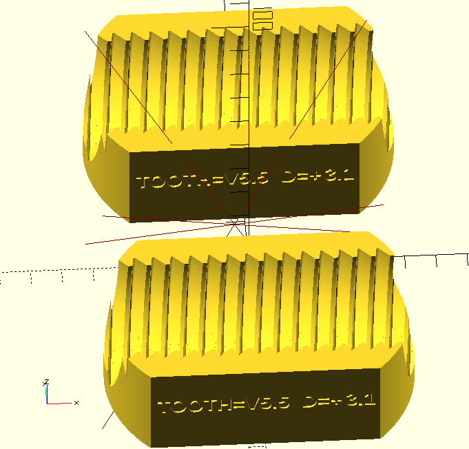

This sounds as if it would be helpful in shaping the tooth of the nuts
for my vise-screw. Making the tooth more exact to what I can carve in
hard maple with a 1/16" SCRN tool for a 4mm high, 12mm pitch, 2 start
buttress thread with the spindle tilted 7 degrees to get the loaded face
of the thread at the right face angle. Something to fine tune the nut
shape of the thread in this .png.
Can this be fixed?
