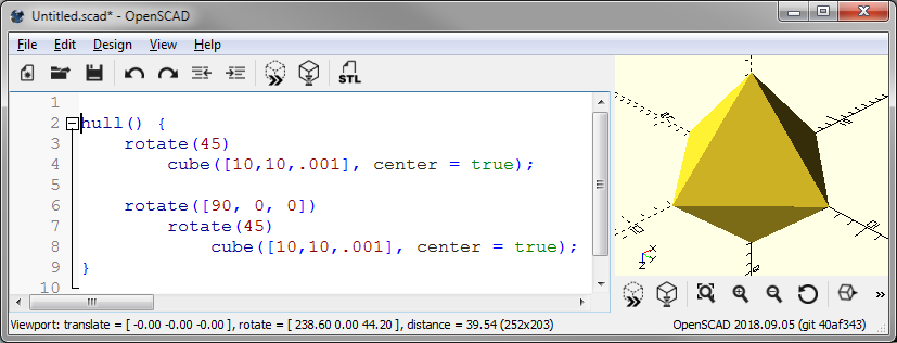

Thank you, it makes sense now. I'm thinking of the axis coming out of each
face and (incorrectly) visualized them coming out of the corners. Actually,
that double pyramid shape will achieve the effect I'm after.
I'm assuming cube(10,10,0.001) gives the pyramid.
Time to play some more.
Thanks all,
Mike.
Thank you, it makes sense now. I'm thinking of the axis coming out of each face and (incorrectly) visualized them coming out of the corners. Actually, that double pyramid shape will achieve the effect I'm after. I'm assuming cube(10,10,0.001) gives the pyramid. Time to play some more. Thanks all, Mike. -- Sent from: http://forum.openscad.org/
Fri, Sep 7, 2018 11:06 AM
It gives approximately a square. The hull of that and one rotated 90
degrees gives the pyramid.
Hull only works on 3D shapes unfortunately.

The double pyramid shape is also known as an octahedron and is one of
the Platonic solids.
Here's another way to make one using "cylinders".
for (k = [0,1]) mirror([0,0,k])
cylinder(r1=1,r2=0,h=1, $fn=4);
Another alternative would be to construct one from points and faces
using the polyhedron module.
