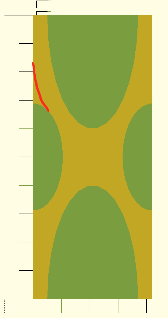

Here's an X shape formed by cutting some ellipses out of a cube.
I would like to smooth the sharp corners on the sides by subtracting
a shape that will be tangent to the side ellipsis and the side of
the cube, as per the red markup in the attached image.
How can I calculate that shape, or otherwise smooth the sharp edge?

Here's an X shape formed by cutting some ellipses out of a cube. I would like to smooth the sharp corners on the sides by subtracting a shape that will be tangent to the side ellipsis and the side of the cube, as per the red markup in the attached image. How can I calculate that shape, or otherwise smooth the sharp edge? $fn=30; ZZ=5; WW=42; HH=100; difference() { cube([WW,HH,ZZ]); // top and bottom translate([WW/2,0,0]) scale([1,2.5 ,1]) cylinder(ZZ,d=WW-(10)); translate([WW/2,HH,0]) scale([1,2.5,1]) cylinder(ZZ,d=WW-(10)); // sides translate([0,HH/2,0]) scale([1,1.8,1]) cylinder(ZZ,r=WW/4); translate([WW,HH/2,0]) scale([1,1.8,1]) cylinder(ZZ,r=WW/4); // smooth the arms // ??? }

Hm, better start in 2D and then try to use offset() for things like this.

Hm, better start in 2D and then try to use offset() for things like this. ZZ=5; WW=42; HH=100; os = 15; linear_extrude(ZZ) intersection() { square([WW,HH]); difference() { offset(-os)offset(os) { translate([WW/2,0]) scale([1,2.5]) circle(d=WW); translate([WW/2,HH,0]) scale([1,2.5,1]) circle(d=WW); } translate([WW/2,0]) scale([1,2.5]) circle(d=WW-(10)); translate([WW/2,HH,0]) scale([1,2.5,1]) circle(d=WW-(10)); } } -- Sent from: http://forum.openscad.org/

This is perfect, thanks very much!

Minkowski is also good for rounding edges and corners.

I use this handy little snippet for rounding corners in 2d:
