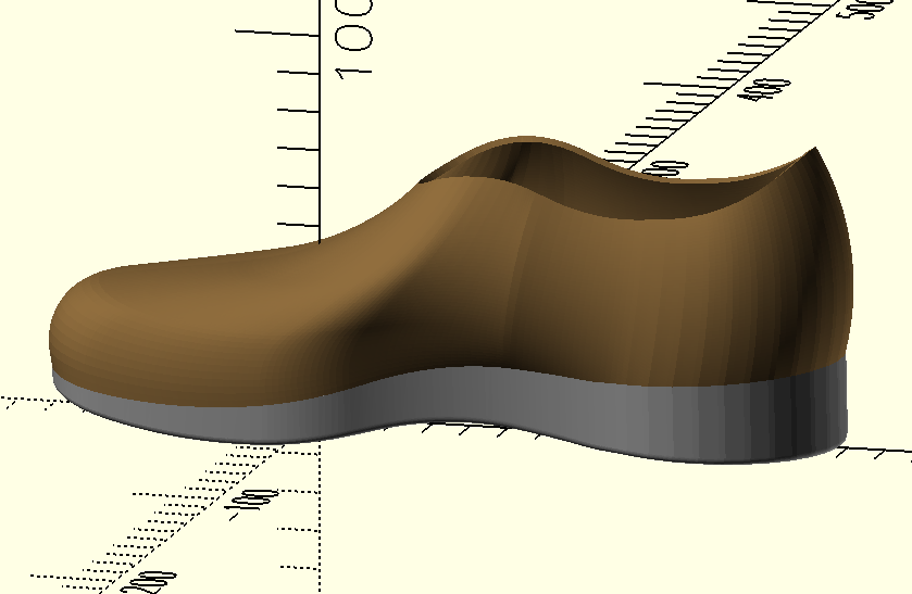

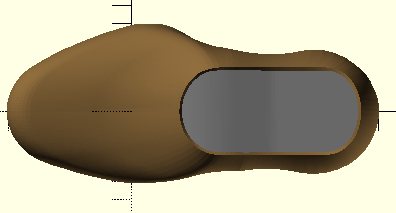

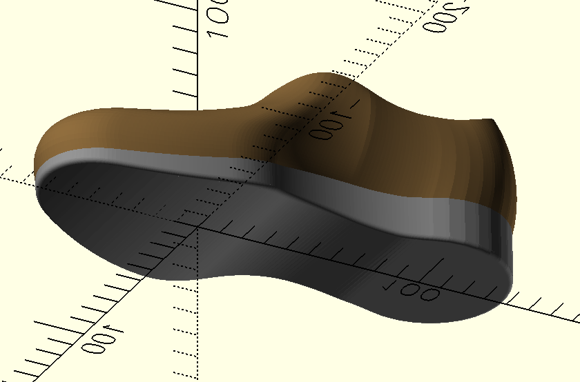

Just modelled a shoe, while trying to create various surfaces and it worked
well. May not be perfect but the concept looks ok

[image: Screenshot 2026-01-26 at 2.32.43 PM.png]
[image: Screenshot 2026-01-26 at 2.34.34 PM.png]
[image: Screenshot 2026-01-26 at 2.33.27 PM.png]
scad file can be downloaded from here:
https://github.com/sprabhakar2006/openSCAD/blob/main/shoe.scad
