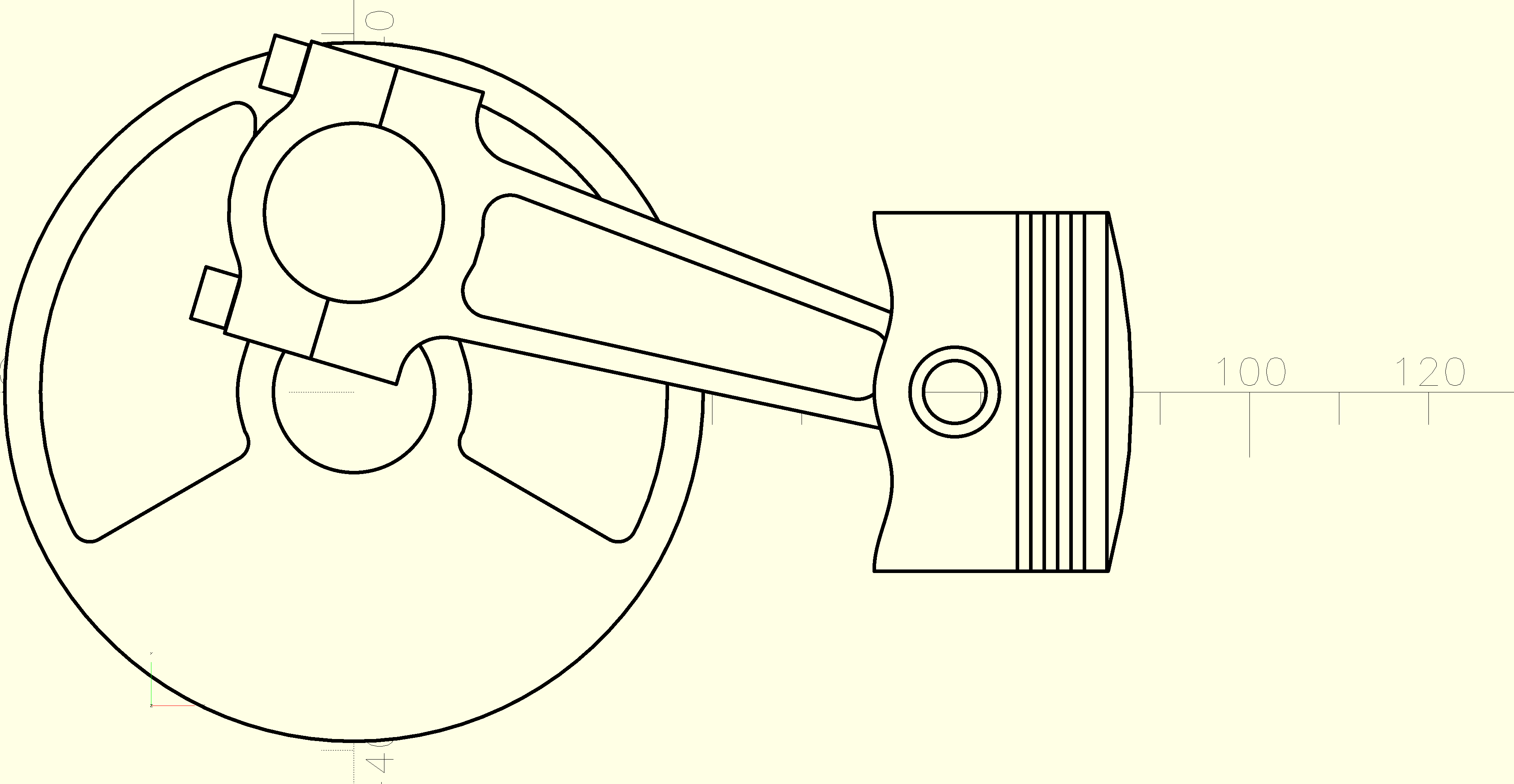

When I need good quality images I use the command line to make then twice
as big as I need on each axis and then use ImageMagik to resample them down
to the size I want. I then get antialiased images.

When I need good quality images I use the command line to make then twice as big as I need on each axis and then use ImageMagik to resample them down to the size I want. I then get antialiased images. On Sat, 1 Nov 2025 at 03:16, Caddiy via Discuss <discuss@lists.openscad.org> wrote: > Jordan Brown wrote: > > Can you share the underlying .SCAD program privately? I'll see what I can > think of in terms of creating higher-resolution images from it. > > Sorry, can’t find your address. Please send me an e-mail with the address > to which you want me to send the program. > _______________________________________________ > OpenSCAD mailing list > To unsubscribe send an email to discuss-leave@lists.openscad.org

I too antialias by scaling down oversized images in docsgen, for generating the BOSL2 wiki. Only downside is the half sized axis reference arrow in the corner.
-Revar

Downsizing larger exported images, is a workaround that should not be
necessary.
It works in a pinch, but the todo list should one of these days be
populated with something that does this automatically.
I acknowledge that doing the antialiasing on the screen is resource
intensive, and has some disadvantages while debugging designs.
But for image export I think people should be able to choose a
higher-quality image than just the same as a screenshot.
#4902 https://github.com/openscad/openscad/issues/4902 Have resolution
option for "Export as Image"
All it takes is somebody with the appropriate expertise, with the time
and interest to do it.
(I'm personally marginal on the expertise - I'm not sure I could do it,
but I'm not sure I couldn't - but I don' t have the time, and the only
reason I might have the interest is altruism; it wouldn't help anything
that I really want to do.)

As a sweetener, I will send you the code for the animated engine, as requested.
For me it’s not urgent. There are so many programs that produce high quality prints that I thought getting OpenSCAD to do the same would not be too difficult for someone with the appropriate expertise.
How about a new program: OpenSCADdraw for armchair engineers? With animation, of course. I have already made a start!

Mon, Nov 3, 2025 8:04 PM
As I suspected, render-and-export-to-SVG yields non-jaggy results, but
only has the outline.  (Enclosed.)
Previewing at a large size works, depending on how large your screen
is.  Enclosed please find a 3840x1988 image that prints pretty well, at
somewhere in the range of 300-400 dots per inch, in the range of early
consumer laser printers but not up to modern 1000dpi standards.
Although many monitors are not capable of that kind of resolution, it
isn't much of an upgrade - I did it on a 4K TV that I paid $200 for at
Costco.  (A 43" 4K TV as your monitor is game-changing.)
The command line can yield arbitrary-size images; enclosed please find
one at 11000x8500, which would in theory be 1000dpi on a US Letter page
(depending on the tool used to print it and the printer).
Here's the command line that generated that image:
--imgsize 11000,8500 --projection o --camera 25,0,300,25,0,0 "4T
engine JBrown.scad"
... but see my private mail for what kinds of things you need to do to
be able to use that command.
Note that I keep several OpenSCAD installs at any one time, which is why
the Program Files path is not for a stock OpenSCAD install.  For stock
OpenSCAD it would be "\Program Files\OpenSCAD\openscad".
Net:  you can get high-quality files (that you can then print using some
other tool).  It would be good if there was a GUI way to do that
arbitrary-size preview, but there isn't.

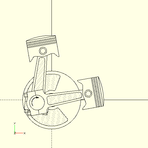

Thu, Nov 6, 2025 3:28 AM
Oh look! It’s sprouted a second piston!
Dance of the cranky connecting rods.
It’s not immediately obvious from the animation, but a 90° V-engine has good balance.
Oh look! It’s sprouted a second piston! Dance of the cranky connecting rods. It’s not immediately obvious from the animation, but a 90° V-engine has good balance.
