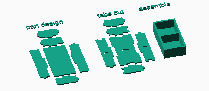

Tue, Feb 5, 2019 7:24 PM
Well, I revised the scheme I had proposed and it is wrong. However, the
behind ideas are worth of considering.
I have attached a code that follows a (big) revision of those ideas. The
following image give an account of the results.
[image: BoxCutting.PNG]
The set of parts at left is the design of the parts in laser cut plan
position with their tabs but without the "voids".
The center set shows the parts after have been processed by cutting the
matching "voids" for the tabs. This process is automated.
At right, the final assembly of the box.
I hope it helps.

Troberg
Wed, Feb 6, 2019 7:24 AM
Yep, that's somewhat what I was looking for. It does get kind of awkward,
though, but I haven't found a neater way to do it, especially when you are
doing boxies with lots of dividers, and not all shapes being square.
