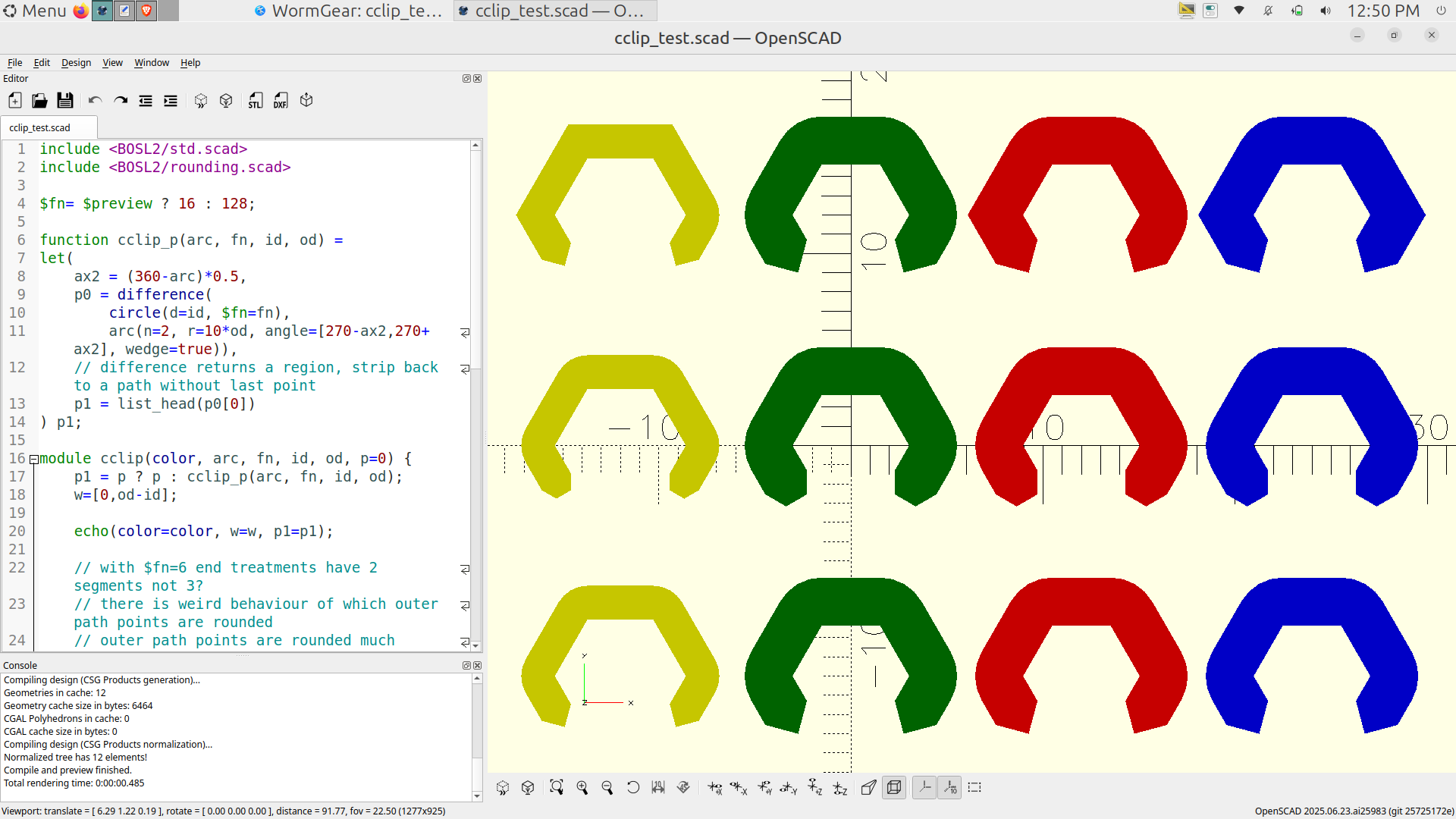

// I think this code demonstrates inappropriate handling of $fn in BOSL2's
offset_stroke().
include <BOSL2/rounding.scad>
$fn= $preview ? 16 : 128;
function cclip_p(arc, fn, id, od) =
let(
ax2 = (360-arc)0.5,
p0 = difference(
circle(d=id, $fn=fn),
arc(n=2, r=10
od, angle=[270-ax2,270+ax2], wedge=true)),
// difference returns a region, strip back to a path without last point
p1 = list_head(p0[0])
) p1;
module cclip(color, arc, fn, id, od, p=0) {
p1 = p ? p : cclip_p(arc, fn, id, od);
w=[0,od-id];
echo(color=color, w=w, p1=p1);
// with $fn=6 end treatments have 2 segments not 3?
// there is weird behavior for which outer path points are rounded
// outer path points are rounded much finer than $fn=6
back(12) color(color) offset_stroke(p1, start="round", end="round",
width=w, $fn=6);
// with $fn=8 end treatments have 3 segments and all outer path points
are rounded
color(color) offset_stroke(p1, start="round", end="round", width=w,
$fn=8);
// with pointed end treatments all outer points are rounded, $fn has no
effect
fwd(12) color(color) offset_stroke(p1, start="pointed", end="pointed",
width=w, $fn=8);
d = 6.82;
// only the right most outer point is rounded
right(-12) cclip("yellow", arc=239.0, fn=6, id=d, od=d+1.75);
// with smaller inner diameter all outer points are rounded
right(0) cclip("green", arc=239.0, fn=6, id=d-0.75, od=d+1.75);
// slightly increased arc and only leftmost outer point isn't rounded
right(12) cclip("red", arc=239.001, fn=6, id=d-0.75, od=d+1.75);
// same points as before but not computed and right most outer point is
also not rounded
red_p = [[-2.28771, -1.29435], [-3.035, 0], [-1.5175, 2.62839], [1.5175,
2.62839], [3.035, 0], [2.28771, -1.29435]];
right(24) cclip("blue", arc=0, fn=6, id=d-0.75, od=d+1.75, p=red_p);

Note that BOSL2 bug reports are best raised as issues on the BOSL2 github.
It appears there is an off-by-one error in the rounding for "round".  There
was also a bug in how offset() handled the facet count that I recently
fixed.

Thanks Adrian!
github.
My apologies.  My frame of mind was still somewhat confused rather than
this is definitely a bug meriting a bug report.  The documentation said
roughly "the number of segments for end rounding and offset rounding are
computed in the usual way with respect to special variables."  I did not
have certainty as to what that meant. I wondered, is each rounding formed
from equal length segments with the number of segments set by a floor or
ceiling?  I  tried to gain clarity with experimentation and the results
made no sense to me but I still wasn't certain what the results should be
or that I wasn't making a mistake in the invocation.  I turned to this
email list as a place welcoming of confused user thoughts and I was
hesitant to pollute the expert developer level discourse on github.
