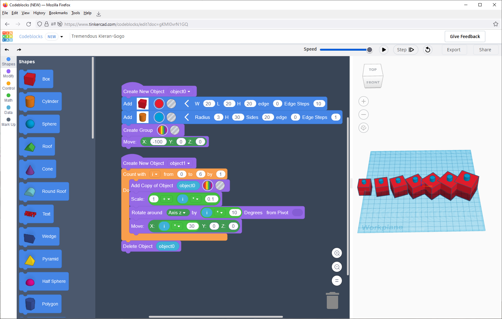

Sat, Sep 4, 2021 8:08 PM
On 9/2/2021 3:01 PM, Whosawhatsis wrote:
If you want to see what it would look like in the other direction,
where you create an object and then move it, give TinkerCAD's
block-code scripting tool a try. It's AWFUL. You're basically
scripting things that you could do with your mouse, and without the
convenience of being able to enclose multiple objects in an operation
or perform operations like rotation relative to a global coordinate
system, it's a lot more work to get anything done than if you were
just using the mouse to do it.
Although I don't think I'd want to work much in that kind of UI, I think
you're selling it short.
I added a block and a cylinder, and then did a "create group", and then
rotated the two of them together.
It seems to be an reverse-Polish environment, a suffix operation
environment, with a bit of a stack.
As for it being harder than using a mouse, yes, sort of... until you
want to go back and change the size of the box at the top of the
program, or change how much it's rotated, or whatever.  That's the big
advantage of any scripting environment, that you can change something
and re-run the program to get a different result.
Here's a non-trivial program that does something slightly interesting:
It's pretty tedious compared to just typing an OpenSCAD program, but on
the other hand it is almost entirely free of syntax.
It's a toy in a lot of ways.  It's hard to imagine building anything
even a little bit complex in it.  But it does let you do the basics.
(If you're wondering what's with the "Delete Object"... Objects aren't
subroutines.  Object0 runs and creates an object, and then Object1
runs and makes and modifies copies of it.  The "Delete Object" deletes
that original object.)
