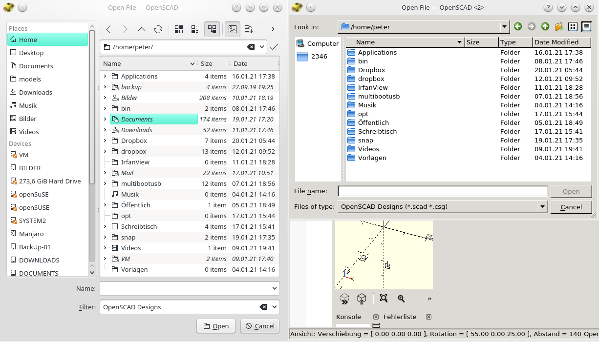

PR
Peter Ragosch
Wed, Jan 20, 2021 3:32 PM
Well, Hans, you are right.
I mean symbolic links to folders that belong to me but are on other
partitions. The links were created in my $HOME like this one:
/home/peter#> ln -s /data/documents Documents
The attached picture shows the "Open File" dialog. Left of OpenSCAD
version 2019.05 (community) and right openscad-nightly 0 + git.2caad75
(snap).
The number of folders is lower on the right - all folders that should
be linked via a symbolic link are missing.
As an aside, links to the internet (help/documentation/etc.) work in
both versions.
Peter
Am Wed, 20 Jan 2021 02:37:17 -0600
schrieb Hans L thehans@gmail.com:
I interpreted that Peter was referring to something about symbolic
links, but it could mean any number of other things, like the links to
"include" or "use" files, or links from the Console or Error Log
warnings to the original source lines...

Well, Hans, you are right. I mean symbolic links to folders that belong to me but are on other partitions. The links were created in my $HOME like this one: /home/peter#> ln -s /data/documents Documents The attached picture shows the "Open File" dialog. Left of OpenSCAD version 2019.05 (community) and right openscad-nightly 0 + git.2caad75 (snap). The number of folders is lower on the right - all folders that should be linked via a symbolic link are missing. As an aside, links to the internet (help/documentation/etc.) work in both versions. Peter Am Wed, 20 Jan 2021 02:37:17 -0600 schrieb Hans L <thehans@gmail.com>: > I interpreted that Peter was referring to something about symbolic > links, but it could mean any number of other things, like the links to > "include" or "use" files, or links from the Console or Error Log > warnings to the original source lines... > > A more detailed description of the problem would certainly help. > > On Tue, Jan 19, 2021 at 8:09 PM MichaelAtOz <oz.at.michael@gmail.com> > wrote: > > > Works for me. > > > > I presume we're talking about Help/Documentation etc. > > > > > > > > OpenSCAD Version: 2021.01.17 > > > > System information: Linux 4.9.0-12-amd64 #1 SMP Debian 4.9.210-1 > > (2020-01-20) x86_64 Ubuntu Core 16 8 CPUs 31.32 GB RAM > > > > User Agent: OpenSCAD/2021.01.17 (Linux x86_64; Ubuntu Core 16) > > > > Compiler: GCC "5.4.0 20160609" 64bit > > > > MinGW build: No > > > > Debug build: No > > > > Boost version: 1_58 > > > > Eigen version: 3.2.92 > > > > CGAL version, kernels: 4.14.3, Cartesian<Gmpq>, > > Extended_cartesian<Gmpq>, Epeck > > > > OpenCSG version: OpenCSG 1.4.2 > > > > Qt version: 5.5.1 > > > > QScintilla version: 2.9.1 > > > > InputDrivers: > > > > GLib version: 2.48.2 > > > > lodepng version: 20180910 > > > > libzip version: 1.0.1 > > > > fontconfig version: 2.11.94 > > > > freetype version: 2.6.1 > > > > harfbuzz version: 1.0.1 > > > > cairo version: 1.14.6 > > > > lib3mf version: 1.8.1 > > > > Features: input-driver-dbus, lazy-union > > > > Application Path: /snap/openscad-nightly/2346/usr/bin > > > > > > > > > -----Original Message----- > > > > > From: Discuss [mailto:discuss-bounces@lists.openscad.org] On > > > Behalf Of > > Torsten Paul > > > > > Sent: Wed, 20 Jan 2021 04:13 > > > > > To: discuss@lists.openscad.org > > > > > Subject: Re: [OpenSCAD] Version 2021.01.17 (Snap) can't follow > > > links > > > > > > > > > > On 19.01.21 17:57, Peter Ragosch wrote: > > > > > > The openSCAD Snap Version 2021.01.17 doesn't follow links in > > > > > > /home/<user> on Manjaro. > > > > > > > > > > > > Who is responsible for the snap? Where should i report this bug? > > > > > > > > > > I'm not sure this is a bug. Snap packages are encapsulated > > > > > by design which likely causes those links to point into > > > > > places that are not visible to the application packaged. > > > > > > > > > > I need to check the documentation to find an official > > > > > statement about handling of links. > > > > > > > > > > I suppose the OpenSCAD github repo would be the correct > > > > > place to report or request things. > > > > > > > > > > ciao, > > > > > Torsten. > > > > > > > > > > _______________________________________________ > > > > > OpenSCAD mailing list > > > > > Discuss@lists.openscad.org > > > > > http://lists.openscad.org/mailman/listinfo/discuss_lists.openscad.org > > > > > > <http://www.avg.com/email-signature?utm_medium=email&utm_source=link&utm_campaign=sig-email&utm_content=emailclient> > > Virus-free. www.avg.com > > <http://www.avg.com/email-signature?utm_medium=email&utm_source=link&utm_campaign=sig-email&utm_content=emailclient> > > <#m_3049544508436542575_DAB4FAD8-2DD7-40BB-A1B8-4E2AA1F9FDF2> > > _______________________________________________ > > OpenSCAD mailing list > > Discuss@lists.openscad.org > > http://lists.openscad.org/mailman/listinfo/discuss_lists.openscad.org > >
DM
Doug Moen
Wed, Jan 20, 2021 5:33 PM
A Snap application is sandboxed, and you can only access files in your home directory.
I have not found a way to override this behaviour, but if anyone else knows a workaround, please post.
I can't use the OpenSCAD snap due to this and other limitations.
However, the AppImage works just fine.
(snap).
