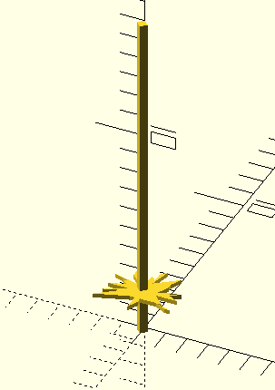

When I run (F5) your code (using the 2021.01 version of OpenSCAD) I see
the following:
CGAL_Nef_Polyhedron.
Geometries in cache: 6
Geometry cache size in bytes: 26272
I tried commenting out one() and then two() and then tried an F6.  It
all seems to work fine now.  I imagine something is in the cache which
is changing the original behavior (with ERROR).
A bit puzzling but I see this now with F6, and without error messages...

one();
two();
module one() {
    // stick
    echo("Starting ONE");
    translate([0, 0, 0])
    linear_extrude(height=16)
    polygon(points= [[0, 0],[-0.250000011875, -0.25000000096],[0,
-0.50000000101],[0.24999999732, -0.25000000096],[0, 0]]);
    echo("Finishing ONE");

    // FAILS
    translate([0, 0, 2])
    linear_extrude(height=0.2)
    polygon(obj_points1, obj_paths1);
    echo("Finishing TWO");
