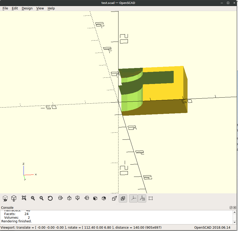

Hello everybody
i need help with this:
with openscad 2018.06.14 from github
this code:
h=9.2-4+.3;
    cube([20,2h,2h]);
    cylinder(d=15,h=h);
        translate([0,0,h])
            cube([17,20,4]);
            cylinder(d=15,h=h);
produces this after rendering:

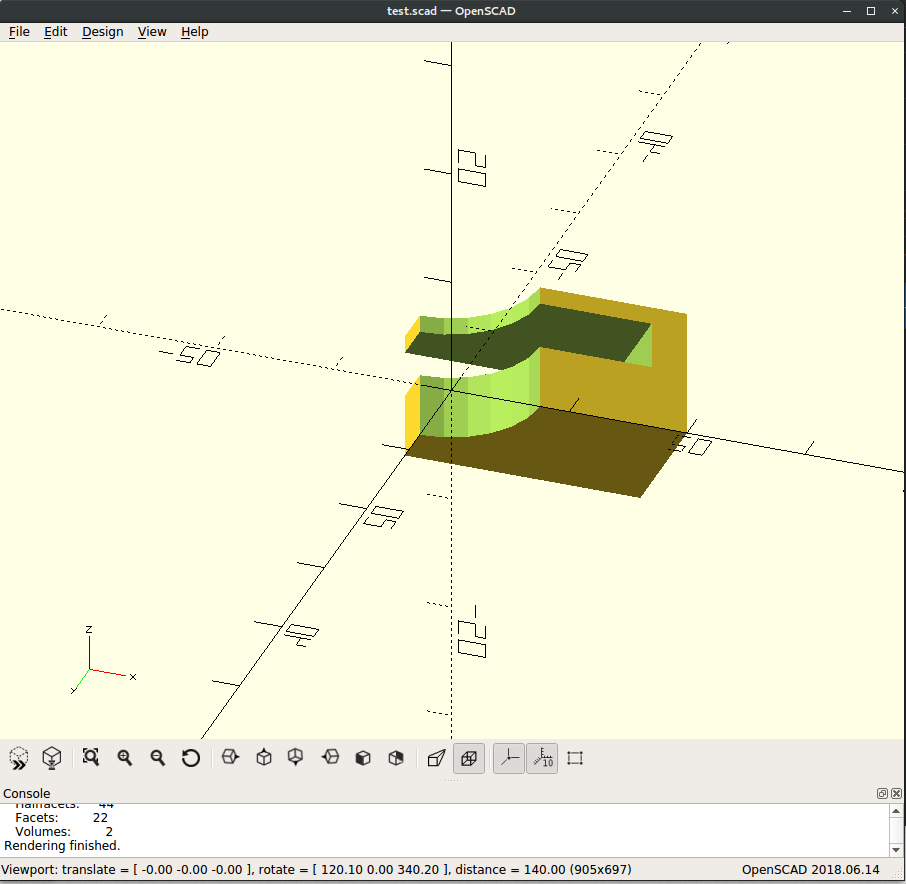

but if you change  the value of h at the first line to
h=5.2+.3;
(which is still the same number as above h=9.2-4+.3 and still equals to
5.5 )
restart openscad to reset cache, and rerender, you will get a different
picture:
anybody knows which version(revision) of openscad is last to be known to
not have this effect?
why do i get 2 volumes anyway?
Thanks for advice. Peter

Try this
h=9.2-4+.3;
h2=5.2+.3;
h3=5.2+.3+0.000005;
echo(h=h,h2=h2,h3=h3);
echo( (h==h2) ? "EQ" : "NEQ" );
echo( h-h2);
Floating point plays tricks, compounded, AGAIN, by echo rounding results.

You get two volumes for a single object because the outside universe counts
as a volume. So you always need to subtract one from what OpenSCAD reports.
Also internal cavities count as volumes, so a hollow sphere would report 3
volumes.
