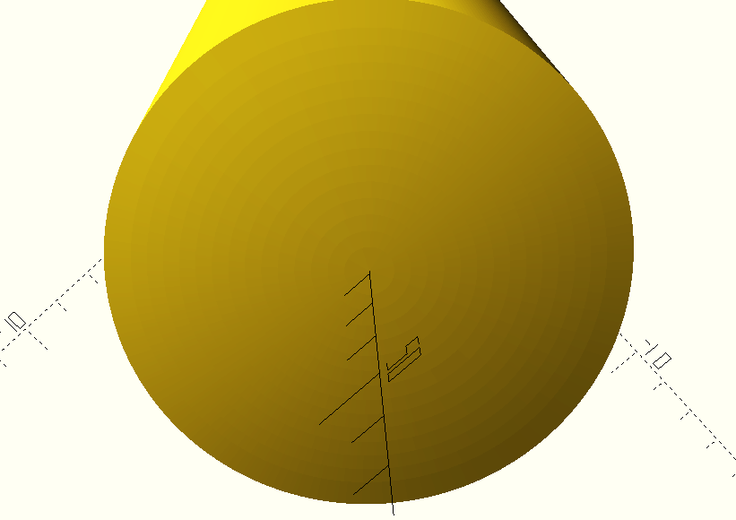

Thanks for the replies and sorry if this starts a second thread - I seem to
be blocked from replying on the web.
I am using 2015.03-2 on Windows which seems rather old but according to the
web site it's the latest version.
Your image looks plenty smooth - basically when I get these things 3d
printed the 'tree rings' are visible and I'd rather they were not.
I don't get a smoother result at $fn=1000. 570 is about as good as it gets
and has about 16 concentric rings.
I can't really use $fn on the proper model because there are also small
radius curves and having so many facets on a small curve will push up the
model complexity too much.
The attached image has the contrast pushed up to hopefully show what I get.
Is there a later version? Are the dev snapshots suitable for everyday use
for example?
Regards, Andy

Thanks. I tried out the snapshot build.
The good news is that it makes a lovely job of my simple example with $fa set to 0.3… which is equivalent to $fn=1200
The not so good news is that the tree rings remain just as bad when doing a rotate_extrude of the DXF with the same setting, same cylinder and dome diameter.
I will need to experiment some more another day. If all else fails I may need to drop the DXF and draw the end using code.
Regards Andy

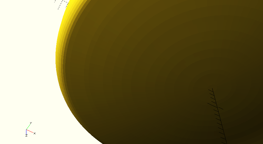

Andy Carlson
Fri, Jan 11, 2019 8:40 PM
Not sure if I can attach a DXF but will have a try...
The code is very simple. It has a general setting for $fs and $fa (as per my
real model which uses these values for other parts) . Then $fa is overridden
for the domed end DXF
$fs=.05;
$fa=2;
profdxf = "end-dome.dxf";
rotate_extrude(convexity=10) {
import(profdxf,$fa=.3);
If I mess with the $fa value on the DXF import then the tree rings get more
in number and smaller down to about $fa=0.65 but as I go lower they don't
continue this behaviour. At 0.3 for example I see irregular sizes of ring -
for example the first complete ring outside the centre is a good deal
narrower than the second. I've attached an image - again with the contrast
increased.
Regards Andy

cbernhardt
Sat, Jan 12, 2019 6:20 PM
I tried your model using your DXF file with many different values of $fn,
$fa, and $fs and it seems that OpenSCAD does apply these variables to arcs
in DXF files the same way as it applies them to objects created by OpenSCAD.
I took your DXF file and did a linear_extrude using various values of $fn.
The picture below shows the STL files of the results.  Looks like 360 is the
upper limit for $fn when inserting a DXF file.  I also tried various values
of $fs and $fa with similar results.
http://forum.openscad.org/file/t1309/arcs.jpg
