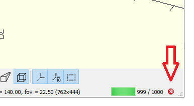

Hi Bryan,
In versoion 2104 I have a little red X in the lower right hand corner that I can
click to cancel.

I just built it from sources, and it's there, at the right end of the
progress bar.
Note that it is there only for F6 renders, not for F5 previews.  In
particular, if your model includes render() or a couple of other
operations that require CGAL, F5 can take a long time but has no
progress reporting or abort mechanism.
Ref #1195 Preview rendering in a separate thread
https://github.com/openscad/openscad/issues/1195.
