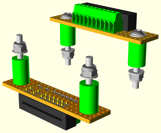

The default camera position is different in the GUI compared with the
command line. I can move the camera but when viewed from the same place in
the GUI the lighting is different. It seems to be higher up in the GUI. Why
are they different?

Seems like the GUI should be changed to match the command line. The command
line looks towards the first quadrant (x+,y+) the GUI default is towards
the third quadrant (x-, y+) which seems like a mistake.

What I don't understand is why the lighting is different. The light comes
from above in the GUI but it seems to be below on the command line.

It seems to be a difference between the vector camera mode and the gimbal
camera mode. If I set the command line to use the gimbal camera with same
viewing angle as the vector camera default then I get the same view but lit
from above as it is in the GUI.
Why would a gimbal camera pointed in the same direction, at the same
distance have different lighting?

I still don’t think this was intentional, so cleaning up and unifying the lighting for the different camera models would be a good step forward.
-Marius

But the lighting code is already the same for both cameras. I don't
understand why it comes out different. Are the lighting positions relative
to the world or the camera?

The two cameras have slightly different ways of managing OpenGL matrices (https://github.com/openscad/openscad/blob/master/src/GLView.cc#L91):
  • The gimbal camera sets up the camera parameters in GL_PROJECTION mode, then resets the MODELVIEW matrix and rotates the scene
  • The vector camera set up the camera projection in GL_PROJECTION mode, then does a gluLookat().
Without looking at this in great detail, I’d guess that the gimbal mode is messing with stuff it shouldn’t do with the PROJECTION matrix, causing the lights to have different relative directions in gimbal and vector modes.
Setting up OpenGL cameras and lights using these low-level functions can be tricky and is error prone...
