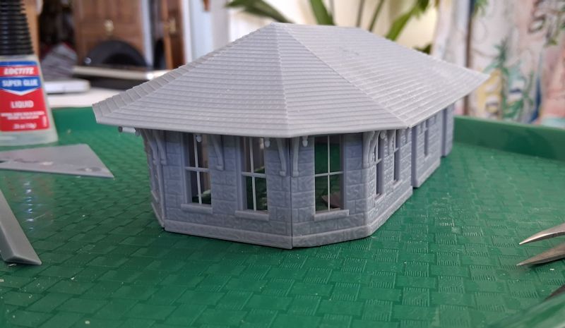

I'm putting the finishing touches on my most recent project, but I'm
considering starting the next one in BOSL2.  That's the thing, once you
start something in BOSL2, it's gotta be all in that, so I'll have some
prep work to find equivalents for all that I do in native OpenSCAD.
To that end, it would seem to me that native OpenSCAD is becoming more
the 'assembly language' of the scripting CAD space, enough primitives
available to allow more capable stuff like BOSL2. Treat it like that,
and making breaking changes to the language becomes more problematic...
Oh, here is my most recent project:
The stone walls are a product of three bespoke c++ programs that feed
OpenSCAD's surface() and polygon() modules.  And, the roof segments were
difference()ed with cutting cubes rotated at the origin...
Glenn
Glenn
