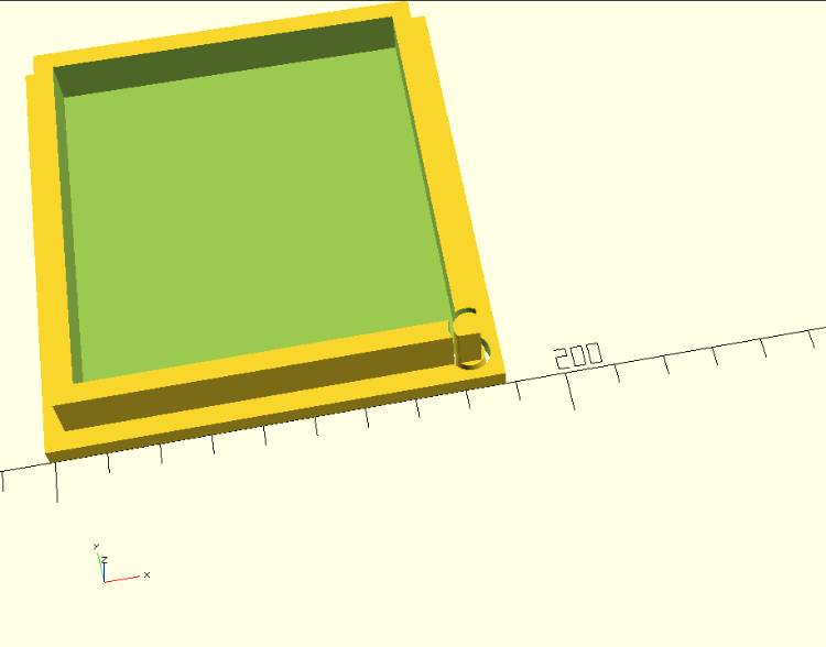

Hello !
I am trying to make a screw hole inside a box lid.
The screw hole:
module lid_screw_hole() {
color("pink") cylinder(h=14,d=8,center=false);
color("blue") cylinder(h=14,d=6,center=false);
And the lid:
*module plain_lid() {
translate([box_side-empty_space+10,0,0]) {
color("red") plain_box(box_side-empty_space, box_side, 4);
    translate([wall,wall,0]) {
        color("green") plain_box(box_side-empty_space-(wall*2),
box_side-(wall2), 14);
translate([wall
2,wall2,0]) {
color("yellow") plain_box(box_side-empty_space-(wall
2)2,
box_side-(wall
2)2, 14);
Naturally, I wanted to make a difference out of these two modules but
something strange happens:
plain_lid();
translate([182, wall+2, 0]) lid_screw_hole();
</file/t2610/openscad1.png>
Making a union() doesn't help either. It just puts them together with no
actual hole inside the cylinder.
Any thoughts ?

Mon, Jul 22, 2019 11:22 AM
Also the picture isn't visible because the forum software is broken at the
moment.
Why are you drilling a hole with a tube and not a cylinder?
The inner cylinder making the tube should be longer than the outer cylinder
to prevent shimmering ends.

Here is the picture, you just copy the /file/... part and add it to forum.openscad.org
That is doing what you have told it to do.
Your hole has a d=8 cylinder hollowed out by d=6 cylinder, so you have a tube.
You then difference the tube from the lid. You get a tube 'hole' with the pin in the middle.
