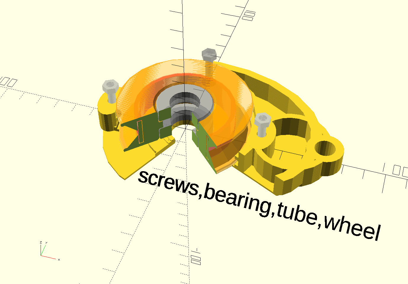

Hello,
the Constructive Library (about 1900 lines of Code) i just have
released https://github.com/solidboredom/constructive,
takes a different approach to OpenScad Syntax: you rarely need
difference(), for(), intersection() or their one-to-one equivalents,
a for() block  In the library's own dialect might look like:
pieces(4)  X(every(35)) turnXY(vals(10,25,-15,40)) cube(10);
It is all valid OpenScad, you do need any additional programs, just
the OpenScad and the constructive-compiled.scad file.
The Constuctive-Syntax tries to align more with mechanical
construction of parts and less with mathematical concepts like
arrays, vectors and functions. (but they are heavily used behind the
scenes). So it aims to be more concise and fluent for mechanical
parts than vanilla OpenScad. It allows you to make holes from
Modules and really good deal more.
For about 5 years now i have been working on it and using it a lot.
Now I really hope others will find it just as useful, as i do. I am
barely writing any vanilla OpenScad any more.
If somebody likes the Ideas, you are welcome to join work on it. It
is released under GPL2, and I appreciate
additions/discussions/collaboration. Perhaps, some Ideas can be used
by the OpenScad itself.
There is barely any documentation yet. I will add it topic-wise,
when any questions arise if there will be interest at all.
For a basic introduction to its syntax and some possibilities, look
at the explanations inside the example below, or ask me directly.
Here is an example with approx 100 lines of actual code  (see also
an animated .GIF in the Attachment):
https://github.com/solidboredom/constructive/blob/main/examples/mount-demo.scad
there is also another Example at:
https://github.com/solidboredom/constructive/blob/main/examples/pulley-demo.scad
There are many more features useful for complex models, like its own
minimalistic type-subsystem,
basic inheritance of construction parts (still needs improvement),
or inverse transformations like in :
g(X(10),Y(15),turnXY(45),X(30))
    g(backwards([X(10),Y(15),turnXY(45),X(30)])
        box(10);
Try it! i hope you will find it as useful as i do.

I will definitely make step by step simple examples  to make up a
tutorial soon
I must admit until now,i had only heard somewhere of BOSL 2. Having
looked around longer time ago and then finding nothing of much help to
me, i had concentrated on my own library which went through several
iterations of syntax change.
this was out of a need: i build complex parts.
with vanilla openscad i get lost in extremely nested and repetitive code
of any complex  model very quickly.
an own module for almost everything, to avoid code duplication, did not
really help. It made my code even more semantically scattered and
dissociated.
so i started to fight nesting and singularities in OpenScad, the
difference() was an obvious target having both ( it treats its first
child differently from all other children, which i call singularity,
which makes you structure your code after difference()'s personal
preferences, and not after your construction intent) so i have created
the SummUp library (still on my Github) . an on and on to reduce not
semantically relevant code nestng even more...
I had assumed other libraries out there are mostly "boxes with a bunch
of customized stuff you can find use for". a bit like going to a flea
market and looking for an old lamp you will reapair, versus creating
your own new lampshade, lamppost, etc.
There was a library for relative coordinates somewhere, which i found
interesting, but it was too complex to use for me, it asked for 3D
vectors and alike in daily use, so i never really dug it.
Looking at the BOSL2 now , this thing seems different, the examples in
the readme.md go a path of trying to align the language to the domain.
Actually, i even used to have  up() (now Z() or XYZ())  and  skewedBox()
in a previous iteration of my library, which is called "humane.scad" and
focused on easy human readability.
and there is also the xcopies(dist,n) which is similar to
pieces(n)X(every(dist)) in the Constructive dialect.
there are definitely a lot  of similarities. It is a pity i did not
notice it well enough, before.
Perhaps the two can be integrated.
I wiil have to look deeper, but perhaps the Constructive has taken the
syntactic departure from mathematical notation even further,
introducing assemble(), add() remove() and the notion of "Parts"
(semantically orthogonal to modules, which i consider more an aspect of
a Part or of several Parts)
I had also changed the preferred style from openscads native module
nesting to sets of functions in parameters, like in
g(X(10), turnXY(30), TOUP()) cube(10);
versus
X(10) turnXY(30) TOUP() cube(10);
which are both valid in Constructive, but the first is preferred for
performance reasons, among other features i brings.
