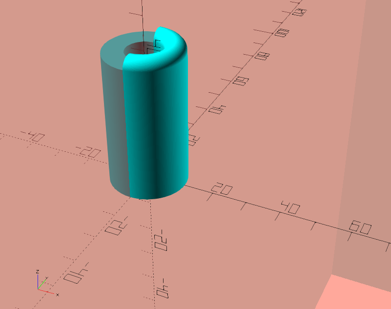

I am working on a project, the most complex thing I've done in OpenSCAD,
and I need cross section views so I can be sure the parts fit
appropriately.
I've tried using a difference with a box to do this job, but it gives very
odd results:

As the attached pic shows, only some of the part is clipped, and this
changes as you rotate the view!
Is there a better way?  I'm used to using clipping planes as in Povray, an
infinite plane which preserves everything on one side and discards
everything on the other side.  The "size" of the plane is therefore always
correct for the object being clipped.

Try with BOSL2's back_half and friends:
https://github.com/BelfrySCAD/BOSL2/wiki/partitions.scad#functionmodule-back_half
and see if those help.
Also, you'll want to Render and not Preview.
-Cory
https://en.wikibooks.org/wiki/OpenSCAD_User_Manual/FAQ#Why_does_difference_(or_intersection)_sometimes_not_work_in_preview?
Keep the camera outside the model, and in particular outside the
invisible parts.

I have this built into my standard starting point files. I can always create a cross section thru the customizer.
-Bob
!start.root.0.scad:

On Jan 3, 2026, at 16:40, gene heskett via Discuss discuss@lists.openscad.org wrote:
appropriately.
odd results:
CubeSize=500;
module HalfClip(){
translate([CubeSize/2,0,0]){ // this puts one face at 0,0,0 of the part.
cube(size = [CubeSize,CubeSize,CubeSize], center = true);
}// end of translate
}// end of module
module HandleBackBuck(){
$fn=180;
union(){
cylinder(h=HandleHigh,r1=HandleRadiusTop,r2=HandleRadius);
translate([0,0,HandleHigh]){
Torus((HandleRadius-3),3);
}// end of union
}// end of module
// This is the module called by the main file
module HandleBack(){
$fn=360;
color([0,1,1])
HandleBackBuck();
translate([0,0,-1]){
cylinder( h=HandleHigh+2, d=(WireDia-0.2));
}// end of difference
}// end of module
// Slice it in half so we can see
module ShowHandleBack(){
HandleBack();
#HalfClip();
}// end of module
ShowHandleBack();
//HandleBack(); // For printing
We cannot load and test this, lots of missing variables.
