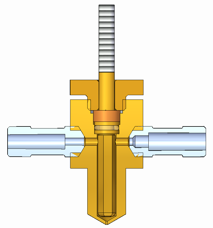

http://reprap.org/mediawiki/images/a/a5/Pia-taubert-material-mixing-report.pdf
is very interesting. It uses a a vertical rod of hexagonal shape that
rotates continuously and actively mixes
two (or in this design up to six different colors) colors together:
[image: Inline-Bild 1]
