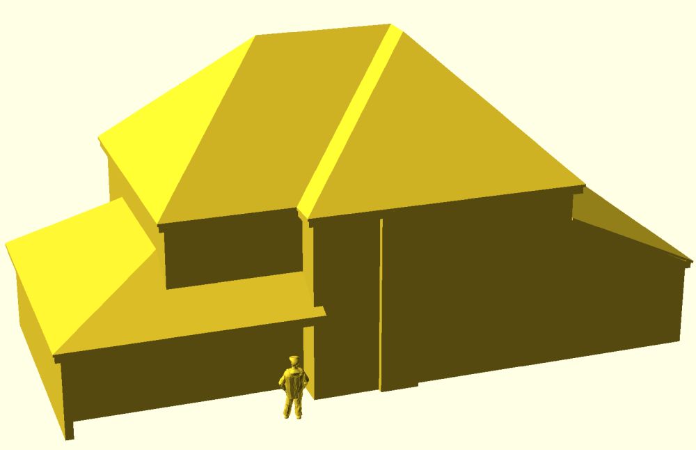

Hi Ray,
Just a postscript to mention that cumulative summing of vector elements
can be done very compactly using list comprehensions.  I am not yet
proficient in working with list comprehensions so would struggle to
write the code myself, but fortunately there's an example in the
documentation. See "Cumulative sum of values in v" at
https://en.wikibooks.org/wiki/OpenSCAD_User_Manual/The_OpenSCAD_Language#for
You end up with:
// points from wall distances
n = [0,1];s=[0,-1];e=[1,0];w=[-1,0];
p =
[e0,w8.5,s38,w5,w95,w110,w50,w4,n37,w75,n7,w44,s8,w52,w62,w70,w39,w69,w43,s90,e*726.5];
function cumsum(v) = [for (a = v[0]-v[0], i = 0; i < len(v); a = a+v[i],
i = i+1) a+v[i]];
polygon(cumsum(p));
Cheers,
Steve

Sun, Jun 30, 2024 7:52 PM
Just thought I'd update.
just need to add roof-tiles, ridge-tiles, windows, doors, chimneys,
gutters and downpipes. I need to get the height of the roof. Maybe jury
rig a crude theodolite. Of course, the actual building is not exactly
square, and combined with my crude measuring system, it was interesting.
Not sure If I'll do much internal detail.
