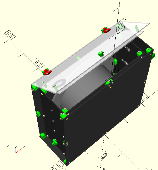

Preview slows down if you have 3D intersections and differences. 3D unions
are fast.
I make a my previews fast making almost everything out of 2D
linear_extrusions and rotate_extrusions unioned together. If I do need a 3D
difference or intersection I factor that bit out and wrap it in render().
That is slow on the first preview but gets rid or any flickering artefacts
and keeps the pan and zoom frame rate high. Also as long as the vertex
count inside the rendered operation is small it doesn't take long.
Typically only a small part of my object gets rendered.
hull() is also fast unless you have an implicit union inside it. I avoid
that by repetition instead of loops and shared translations or rotations.
A complex assembly like this takes 11 seconds to render the first time, 2
seconds for a simple change like moving the door with customiser. It pans
and zooms fluidly and there are no z-fighting artefacts.
