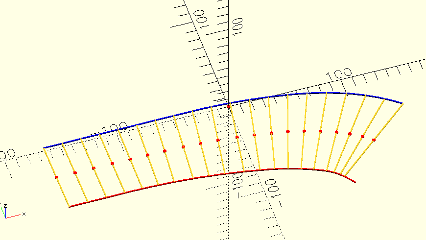

reverse engineering of sax bell I got two curves and import it to openscad.
Now I need a way to build central path and diameter curve.
Or I need to seeep circle between these pathes?

I try closest points, not as good.

path0=resample_path(path1,20,closed=false);
for (pt=path0){
c1 = path_closest_point(path2, pt);
pt2 =c1[1];
path3=[pt,pt2];
color("red") translate(path3) circle(d=3, $fn=12);
stroke([pt,c1[1]]);
//echo(path3);
cpt=[pt[0]-(pt[0]-c1[1][0])/2,pt[1]-(pt[1]-c1[1][1])/2];
//echo("cpt=",cpt);
color("red") translate(cpt) circle(d=3, $fn=12);
