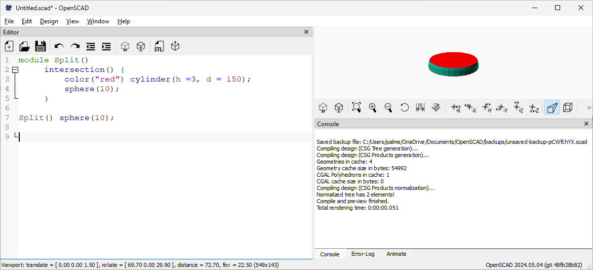

I never use children, and this simple use has me thinking I do not
understand the concept at all.
I expected to see a slice of the sphere, but I see the sphere plus the
cylinder.
module Split() {
    intersection()
        color("red") cylinder(h =3, d = 150);
        children(0);
Split() sphere(10);

On 15.10.24 16:59, Jon Bondy via Discuss wrote:
module Split() {
    intersection()
        children(0);
Split() sphere(10);
Due to missing {} the effective code is:
intersection() { cylinder(); }
sphere();

Yes, with the correct brackets it works.

Tue, Oct 15, 2024 7:41 PM
Thanks!  LOL!  I was so focused on children() that I stopped programming
entirely!
