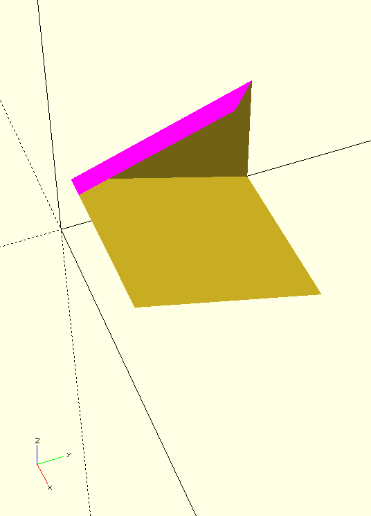

I've been working on a custom polyhedron, and want to make some circular
holes through it for motor spindles.
I've been using difference and cylinders, but on export it complains "Object
may not be a valid 2-manifold and may need repair!".
I have checked it in thrown together view, but all seems fine and correctly
orientated. I have also tried removing the cylinders and it then doesn't
report any warnings on export.
I've also tested with a simple polyhedron cube and a cube differenced
against that which works fine, which means I can do it in principle, but I
just can't figure out why it's misbehaving for me.
My research across the internet has yielded things to check but doesn't help
at all pinpointing my issue, but I could be missing something obvious.
Any help would be greatly appreciated. My code is below.
Many thanks
Chris

Just by visual inspection (after cutting the top off with a cube) the
walls you are drilling the holes through appear to be made of two thin
sheets, rather than being thick and solid...

Create your main shape using solid primitives, like cube() and modify
them using difference() or intersection(); then cut the holes using
difference() and cylinder()

Its apparent you have used the method of trying to construct a complex
polygon. This is fairly unusual approach in OpenSCAD, which is designed to
construct objects by boolean ops on simple primitives. It is a common
approach in polygonal modellers.
I'd suggest a different approach where you considered how the object could
be made if you had a pile of blocks, cylinders and spheres and could union
them together or intersect, subtract(difference) them from each other to
make your desired shape.

Its apparent you have used the method of trying to construct a complex polygon. This is fairly unusual approach in OpenSCAD, which is designed to construct objects by boolean ops on simple primitives. It is a common approach in polygonal modellers. I'd suggest a different approach where you considered how the object could be made if you had a pile of blocks, cylinders and spheres and could union them together or intersect, subtract(difference) them from each other to make your desired shape. E.g. module _wedge_cut(X,Y,Z) { angle = atan(Z/Y*0.5); translate([-Delta/2,0,Z/2]) rotate([angle,0,0]) cube(size=[X+Delta, Y*1.4, Z]); } Delta = 0.1; module wedge(X,Y,Z) { difference() { // cube cube(size = [X, Y, Z]); // remove top _wedge_cut(X,Y,Z); // remove bottom translate([0,0,Z]) mirror([0,0,1]) _wedge_cut(X,Y,Z); } } difference() { // primary wedge wedge(width, length, height); // subtract interior translate([wall_thickness,0,wall_thickness*2+Delta]) wedge(width-wall_thickness*2, length-wall_thickness*2, height-wall_thickness*2); // subtract tube #translate([-Delta/2,(length-motor_offset_from_rear),(height/2)]) rotate([0,90,0]) cylinder(h = width+Delta, r = motor_hole_radius); } -- View this message in context: http://forum.openscad.org/Unable-to-difference-a-polyhedron-with-a-cylinder-tp15850p15854.html Sent from the OpenSCAD mailing list archive at Nabble.com.
Sun, Jan 24, 2016 10:18 AM
It is perfectly valid to make objects with polyhedron if you happen to know
all the vertices. It is faster to render than CSG but harder to program.
The reason it doesn't work in this case is because the polyhedron is non
manifold. It has T junctions at the inside front of the wedge. I.e. a
vertex that meets an edge instead of other vertices. That creates a hole in
the mesh topologically, although you can't see it because it has zero area.
The solution is simply to add two extra vertices to the inner bottom.
   [12,10,6,8,11,14],//inner bottom
E.g.
angle = atan(Z/Y0.5);
rotate([angle,0,0])
1.4, Z]);
