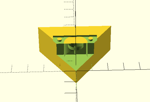

If you compile the following code with F5 you will get a part of a mold
that I am designing.  You will have to revise the "import" code so that
it can see the STL that I have attached.
Bug 1: if you align the visualization as shown in the screen shot, there
is a "ghost" that is sometimes visible.  This can be confusing and
distracting: is it really there or not?
Bug 2: if you now compile with F6, the mold disappears and a triangular
solid appears.  The "difference" has vanished.  So, the mold is
effectively useless.

On May 14, 2015, at 11:40 AM, jon jon@jonbondy.com wrote:
Bug 1: if you align the visualization as shown in the screen shot, there is a "ghost" that is sometimes visible.  This can be confusing and distracting: is it really there or not?
Add ‘convexity=3’ as a parameter to import(). This is to tell OpenSCAD that your imported geometry is has high depth complexity.
Bug 2: if you now compile with F6, the mold disappears and a triangular solid appears.  The "difference" has vanished.  So, the mold is effectively useless.
This is because your imported STL has degenerate features not supported by OpenSCAD. Typically, this means you have “zero area triangles” - triangles where we can’t deduce a normal vector. Our geometry engine (CGAL) doesn’t support this. It’s a known issue and pretty annoying indeed.
See https://github.com/openscad/openscad/issues/945 and https://github.com/openscad/openscad/issues/1042
-Marius

Thu, May 14, 2015 4:29 PM
The first problem is fixed by setting convexity in the import.
The second problem is:
violation! Expr: pe_prev->is_border() ||
!internal::Plane_constructor::get_plane(pe_prev->facet(),pe_prev->facet()->plane()).is_degenerate()
File:
/data/OpenSCAD/libraries-mingw32-master/mxe/usr/i686-w64-mingw32.static/include/CGAL/Nef_3/polyhedron_3_to_nef_3.h
Line: 293

Thu, May 14, 2015 4:35 PM
Thanks (and to nop head).
The STL was created by SketchUp.  Is there some way to "fix" the STL?
NetFabb Basic claims the STL is OK.

Thu, May 14, 2015 4:50 PM
On 05/14/2015 06:35 PM, jon wrote:
The STL was created by SketchUp.  Is there some way to "fix" the STL? NetFabb Basic claims the STL is OK.
On 05/14/2015 06:35 PM, jon wrote: > The STL was created by SketchUp. Is there some way to "fix" the STL? NetFabb Basic claims the STL is OK. > You could try meshlab: https://github.com/openscad/openscad/wiki/Frequently-Asked-Questions#why-is-my-imported-stl-file-only-showing-up-with-f5-but-not-f6 ciao, Torsten.
Thu, May 14, 2015 6:20 PM
I gave up and re-invented the STL in OpenSCAD.  The lesson?  Never use
anything other than OpenSCAD!
