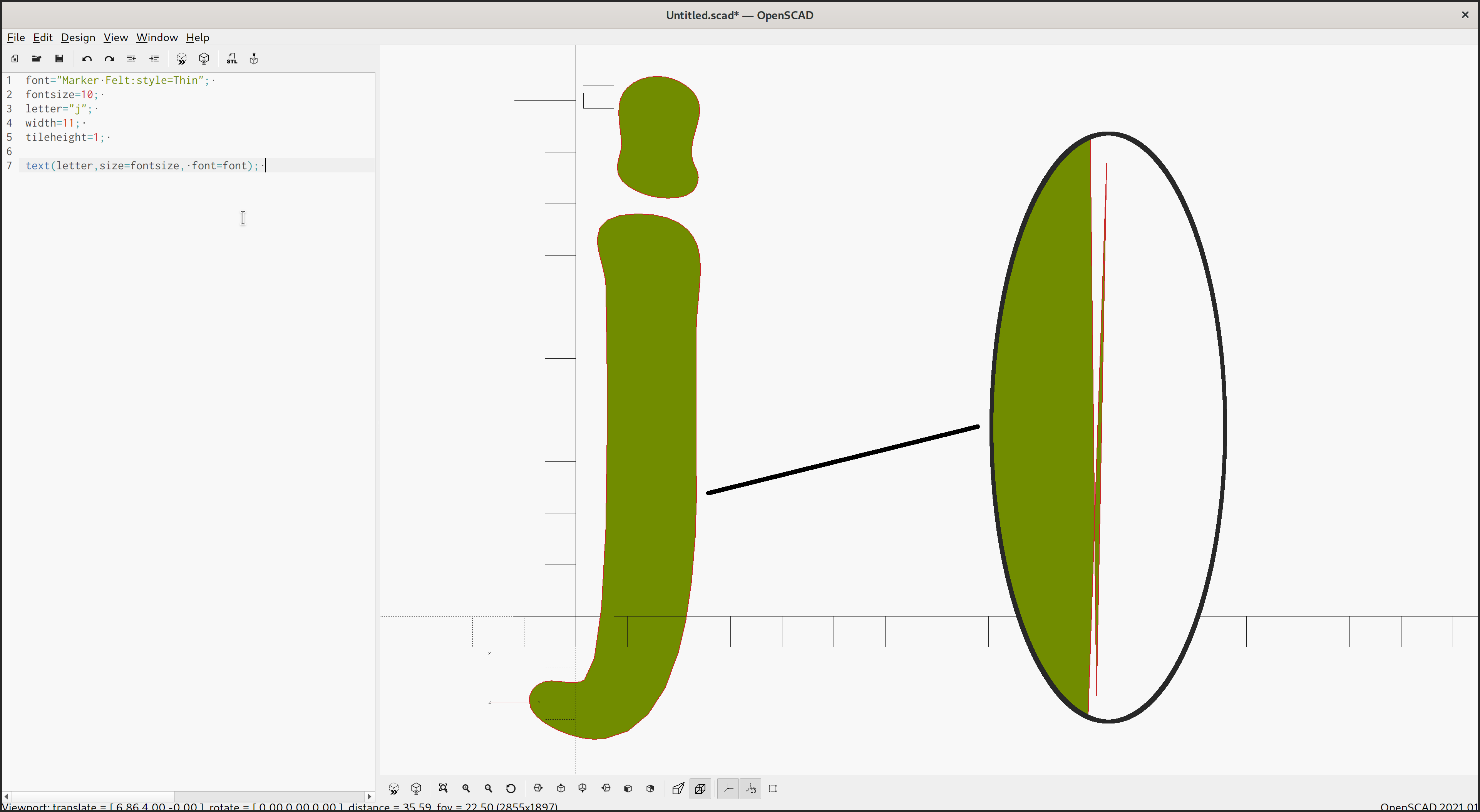

I also have  20220.01 on my M1 Mac so have done a little digging.
Getting rid of all the extraneous translates/rotates
font="Marker Felt:style=Thin";
fontsize=10;
letter="j";
width=11;
tileheight=1;
cube ([14,14,1]);
linear_extrude(height=6) text(letter,size=fontsize, font=font);
The J is present with F5 and disappears with F6.
Make the J and cube discontinuous also makes no difference
Comment out the cube and the J is present with both F5 and F6.
Adding the Offset suggested fixes the problem
linear_extrude(height=6) offset(0.001) text(letter,size=fontsize, font=font);

On 29 May 2021, at 16:33, nop head nop.head@gmail.com wrote:
I meant try something like this:
translate([0,-4.2,0])
offset (0.001)
If the J in the font has an outline that self intersects then offset() uses the Clipper library and that is very good at fixing 2D self intersections.

Sat, May 29, 2021 4:14 PM
If you zoom in to the section marked by the attached screenshot
you'll find the reason for the issue.
If you zoom in to the section marked by the attached screenshot you'll find the reason for the issue. ciao, Torsten.

make a little offset and it will render (F6).
like so:
cube ([14,14,1]);
font=font);

Thank you everyone!
I've added the offset to my code and everything seems to be good.
