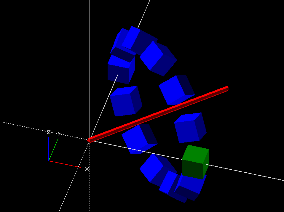

Hello,
I'm new to OpenSCAD and I have a little problem with Rotate. rotating around
2 axis does not work properly for me. see the source in screenshots please.
I typed all objects manually to prevent any mistake in modules
here is what I want to achieve
http://forum.openscad.org/file/n16972/openscad2.png
here is what I get
http://forum.openscad.org/file/n16972/openscad.png
the difference is in the style how I use the rotate function.
rotate(a=45,v=[1,1,0]) - this rotates object improperly
rotate([45,45,0]) - this rotates object improperly
rotate(a=1,v=[45,45,0]) - this rotates object properly but i cannot use it
because the X and Y angles are not the same in my project
could please somebody explain the difference in these three examples? maybe
they are totally different or should not be used like this. thank you!

The reason your rotate(a=45,v=[1,1,0]) example works is because you are
specifically rotating around the axis defined by x=1,y=1,z=0.
To help visualize this, try the following:
// The axis of rotation
v = [10,10,0];
// Do the rotation
for(t=[0:30:359])
rotate(t, v) translate([10,0,0]) color(t==0?"green":"blue") cube(2,
true);
// Visualize the plane
color("red") hull() {
sphere(.25);
translate(v) sphere(.25, true);
It should look like this:

Hi Hypher,
thanks for the explanation, now I finally got it. So I need to create axis
by defining a vector and then tilt the object on the surface defined by
0,0,0 and the new axis.
this is what helped to explain
BIG THANKS!!!

v is the axis of rotation, so the following v settings are the same:
v= [1,1,0]
v= [45,45,0]
v= [100,100,0]
They all mean a line on the xy plane, from [0,0,0] and divides xy plane by
equal halves. It'd be 45-degree to the x-axis and 45-degree to y.
So your first style is basically the same as the 3rd one, except they rotate
by different angles --- rotate the 3rd one 45 times would be the same as
rotate the 1st one once.
The second one rotates about x by 45, then rotate about y by 45.

that I need to split it into two rotates because I want a different order.
On 9 April 2016 at 19:17, Carsten Arnholm arnholm@arnholm.org wrote:
On 09. april 2016 19:18, doug moen wrote:
In summary, the rotate([x,y,z]) interface is tricky to understand. I
haven't worked through the math to come up with a way to predict what
the resulting axis of rotation is.
In my opinion the interface is not usable if you consider the values
angles around the global axes as you explained. the only practical way to
use it is to apply one value at a time and leave the others zero.
To rotate e.g. 30 degrees around Y followed by 60 degrees around X, you
need to do
rotate([60,0,0]) rotate([0,30,0]) cube([10,20,30]);
The above is not at all the same as
rotate([60,30,0]) cube([10,20,30]);
For this reason I introduced a different interface in AngelScript CSG
where there are rotate_x(angle), rotate_y(angle), rotate_z(angle) operators.
There is however, one scenario where the OpenSCAD rotate syntax makes a
lot of sense: when you rotate around some arbitrary axis. For example to
rotate 60 degrees around the axis [x,y]=[1,1]
rotate(a=60,v=[1,1]) cube([10,20,30]);
This format makes sense and can be extended to 3d, but in practice I guess
it isn't much used.
>In my opinion the interface is not usable if you consider the values angles around the global axes as you explained. the only practical way to use it is to apply one value at a time and leave the others zero. In my experience most objects get rotated by +/-90 or 180 around one of more of the global axes, so I can always pick and order that is x,y,z and use a single rotate([x, y, z]). Nearly always one of those is 0. It is rare that I need to split it into two rotates because I want a different order. On 9 April 2016 at 19:17, Carsten Arnholm <arnholm@arnholm.org> wrote: > On 09. april 2016 19:18, doug moen wrote: > >> In summary, the rotate([x,y,z]) interface is tricky to understand. I >> haven't worked through the math to come up with a way to predict what >> the resulting axis of rotation is. >> > > In my opinion the interface is not usable if you consider the values > angles around the global axes as you explained. the only practical way to > use it is to apply one value at a time and leave the others zero. > > To rotate e.g. 30 degrees around Y followed by 60 degrees around X, you > need to do > rotate([60,0,0]) rotate([0,30,0]) cube([10,20,30]); > > The above is not at all the same as > rotate([60,30,0]) cube([10,20,30]); > > For this reason I introduced a different interface in AngelScript CSG > where there are rotate_x(angle), rotate_y(angle), rotate_z(angle) operators. > > There is however, one scenario where the OpenSCAD rotate syntax makes a > lot of sense: when you rotate around some arbitrary axis. For example to > rotate 60 degrees around the axis [x,y]=[1,1] > > rotate(a=60,v=[1,1]) cube([10,20,30]); > > This format makes sense and can be extended to 3d, but in practice I guess > it isn't much used. > > Carsten Arnholm > > > _______________________________________________ > OpenSCAD mailing list > Discuss@lists.openscad.org > http://lists.openscad.org/mailman/listinfo/discuss_lists.openscad.org >
DM
doug moen
Sat, Apr 9, 2016 8:05 PM
is
For this reason I introduced a different interface in AngelScript CSG where
If you define the basis vectors
X = [1,0,0];
Y = [0,1,0];
Z = [0,0,1];
then
rotate([a,0,0]) is rotate(a,X)
rotate([0,a,0]) is rotate(a,Y)
rotate([0,0,a]) is rotate(a,Z)
That's a more flexible alternative to rotate_x(), rotate_y(), rotate_z().
The same arguments would work with mirror(), which takes a vector argument:
mirror(X) -- reflect through the origin along the X axis
mirror(Y)
mirror(Z)
need to do
it isn't much used.
