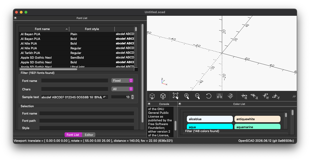

Mac -  here is what I get when I just launch the app:
How do I get rid of Font List and Color List coming up every time ?

That's a bug.  The intent is that the window configuration is saved when
you quit, so just close them and they should stay closed.  I see that
you're running 2026.06.12; a quick test (happens to be with 2026.08.29)
suggests that it's fixed.

Yeah, looks like it was fixed about July 11, in PR#6885.

Version 2026.09.23 no longer has the bug. Thanks!
