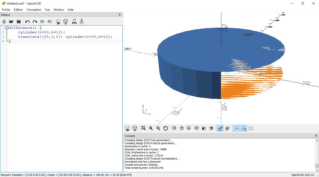

Hello,
A question please...
What's the explanation of the visual glitch below?

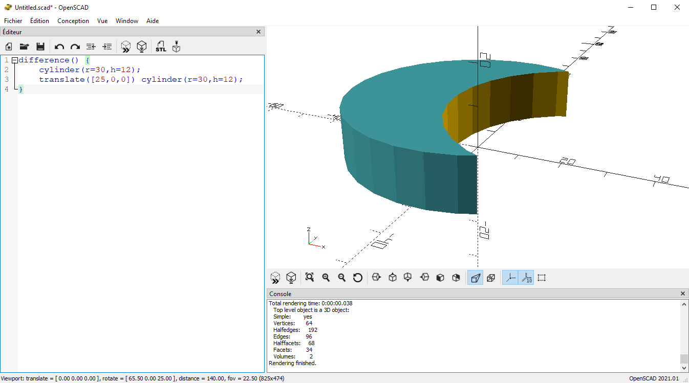

Are these two surfaces (in the preview) a problem?
Thank you![image: surf.png]
[image: surf2.png]
Hello, A question please... What's the explanation of the visual glitch below? Are these two surfaces (in the preview) a problem? Thank you![image: surf.png] [image: surf2.png]

Hi!
Openscad has problems deciding if the planes exist or not since you're subtracting a cylinder of the same height from the original one.
Change the translate to ([25,0,-1])
and the subtracted cylinder to (r=30, h=14)
Now the render will have no issues.
It'll render faster, too...

Here's the documentation: https://en.wikibooks.org/wiki/OpenSCAD_User_Manual/FAQ#What_are_those_strange_flickering_artifacts_in_the_preview?

Ok the problem is the floating point values, thanks

It is not that simple.  The two surfaces are in the exact same place,
floating point or not.  And in the case of OpenSCAD, I believe that
coordinates are not stored as floating point

Eh, not really.
You'll see this behavior with simple integer cases.
    cube(2);
    cube(1);
The problem is not unique to OpenSCAD.  See
https://en.wikipedia.org/wiki/Z-fighting for a generic discussion.

I fix this by including a "zff = 0.001;", for "Z-Fight Fudge", constant at
the top of my files. When the z-fighting in the previous is particularly
troublesome I can use zff to make something slightly taller, or shorter, or
moved slightly, to eliminate the ambiguity of which face is closer to the
camera. The value is too small to cause any dimensional problems for the
things I work on, but it can be set back to 0 for exporting if you're
paranoid.

I'd read somewhere that OpenSCAD likes binary numbers. To that end, my "addabit" is 0.128 or 0.0128 for correcting this type of problem. A specific primitive being subtracted is sized with " + addabit" and translated with " - addabit / 2" with good (fast) results.

What /is/ unique to openscad is that it happens with stuff that is
invisble.
Hmm. My example now doesn't do it:
cube (10);
difference () {
cube ([20,9,8]);
translate ([-5,5,5]) cube ([30,5,5]);
In more complex cases I see it happening when the object that is
subtracted from something else conincides with a plane of something
visible.

Ok, thank you to all the people who responded, all your input was helpful.
I like the idea of the variable at the beginning of the program with a
small epsilon
