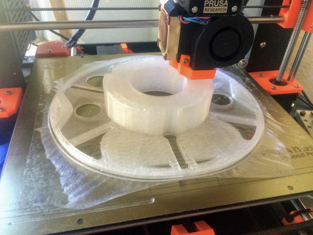

definitely! There is NO comparison to PETG! It is  c.o.m.p.l.e.t.e.l.y
different. Additionally PP has stronger warping. I have very good
experience with PP adhesive film
https://smile.amazon.de/gp/product/B001AVL0Y8
Look at this Foto: it warped like crazy but still sticked to the bed and
the print could be ended and I can use this master spool.
[image: 55FD34D8-7A7B-451B-A879-479F036EDDA1_1_105_c.jpeg]
and the print could be ended and I can use this master spool.
That is an impressive amount of warping!
