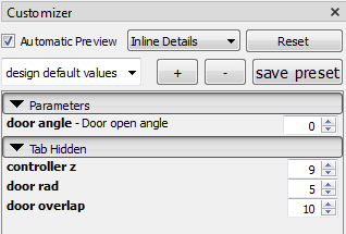

I have played with the customizer for the first time today. I have several
constants at the top of my file that are not parameters to be adjusted,
they are just named constants. The documentation on the wiki says I can
create a hidden tab that will stop them being displayed, but it doesn't. I
just puts them on a tab named Hidden.
E.g.
/* [Tab Hidden] */
Am I missing something?

On 11.02.19 00:21, nop head wrote:
E.g.
/* [Tab Hidden] */
The Thingiverse docs (http://customizer.makerbot.com/docs)
say it should be just /* [Hidden] */
So maybe just a bug in our documentation.

The other thing that stops it is a module, I have used
a=1;
module stop() {}
b=2; // b not in customizer

https://en.wikibooks.org/wiki/OpenSCAD_User_Manual/WIP#[Hidden]
That is not wrong. I mean: The documentation is not nicely worded, as it

Both documents are misleading because they show how to create a tab with a
name and then say "Three tabs names have a special functionality;"  and " The
following tab names are reserved for special functionality: " . So I tried
[Tab Hidden] [Tab][Hidden] and [Tab [Hidden]].
It isn't a tab name at all, it is something that is not a tab. So not an
English language problem, it's logically incorrect.
The Thingiverse one follows it with an example, so they get away with it.
